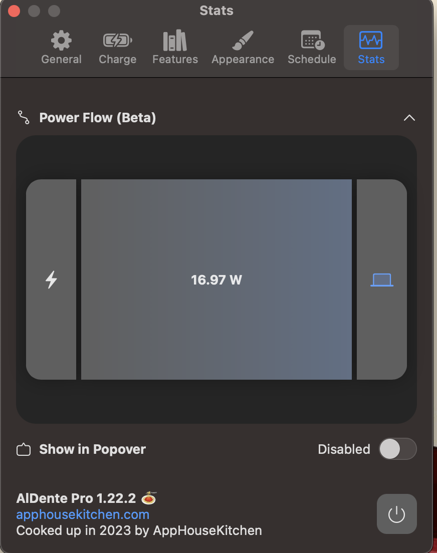

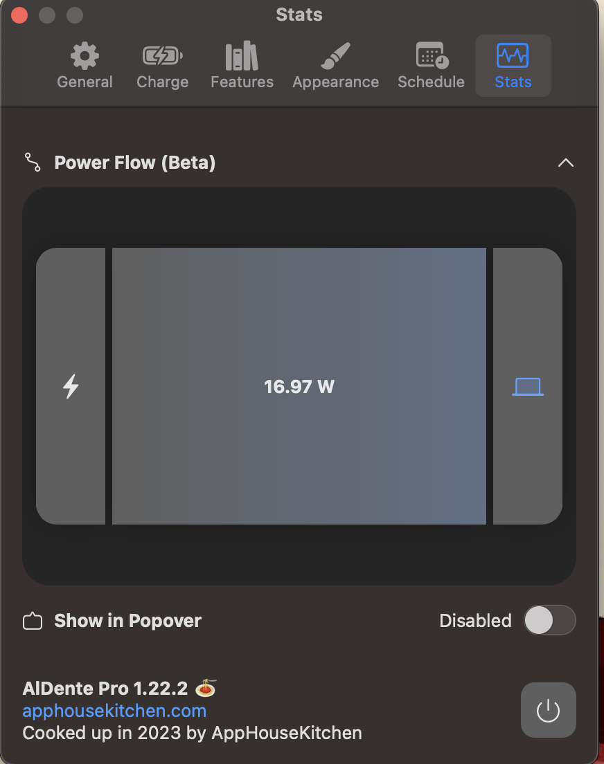

Power Flow with all my peripherals connected.

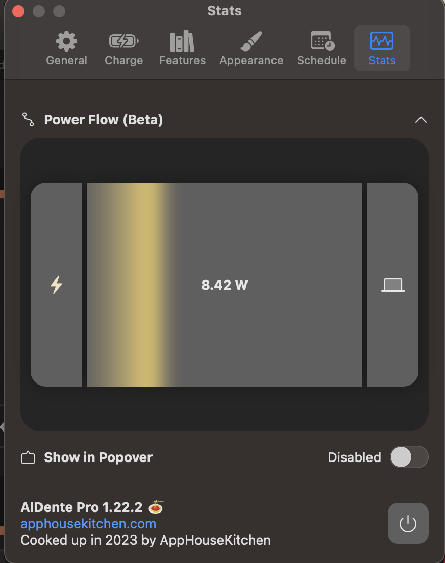

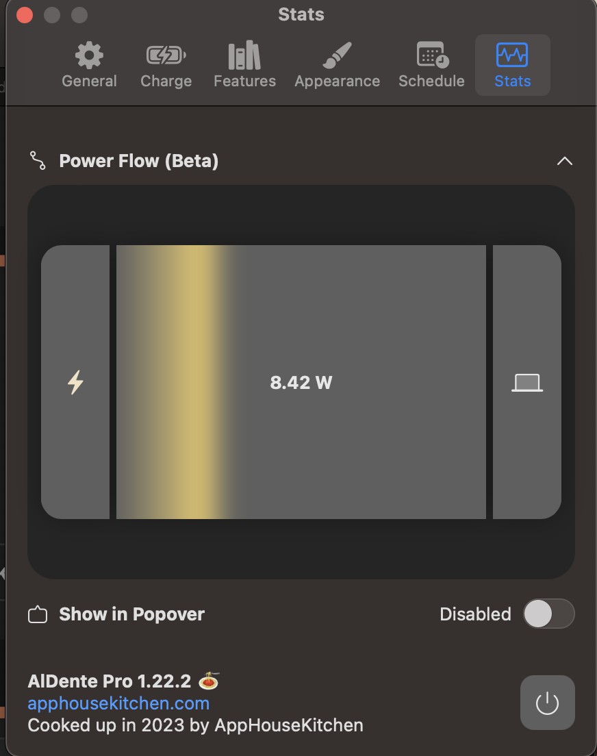

None of them connected:
