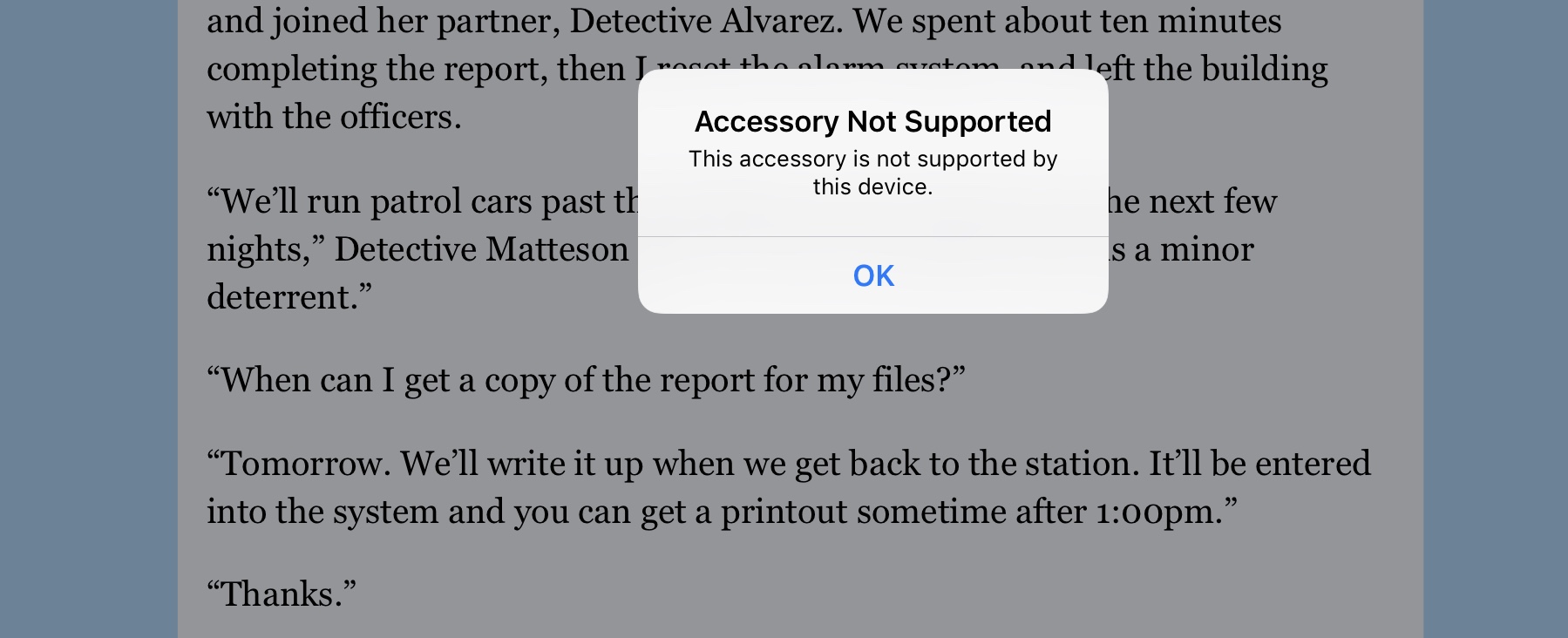

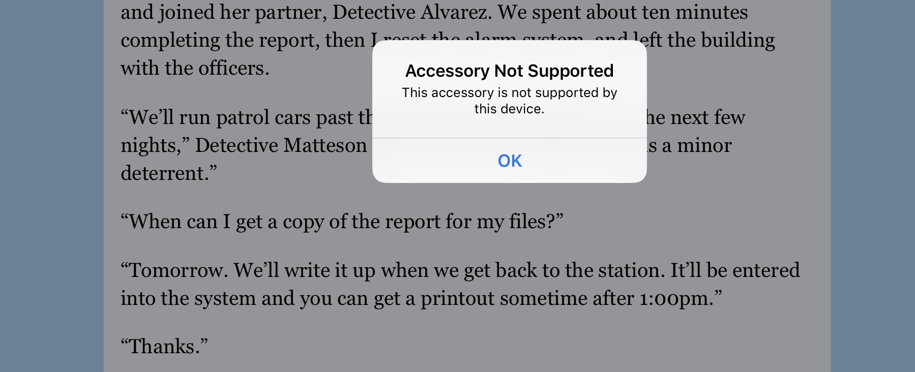

btw - a new issue. Bare IPP with nothing attached, I get the following alert, randomly -
Was reading in Safari.

I also got a free replacement for my Smart Keyboard (which was spamming me with the "This accessory may not be supported." popup when connecting it,) despite it being out of warranty for like half a year.
May have to try that. Am getting that message also but not always when the ASK is attached 🙁
Mine wasn't that super frequent either, but enough to be annoying. The error message came once or twice a day. At least once a week the Keyboard also wouldn't connect without restarting the iPad. The Apple guy said they are allowed to exchange it past warranty if it has some kind of connection issues. He wasn't really testing it though, so he just believed my report on it not connecting properly.
