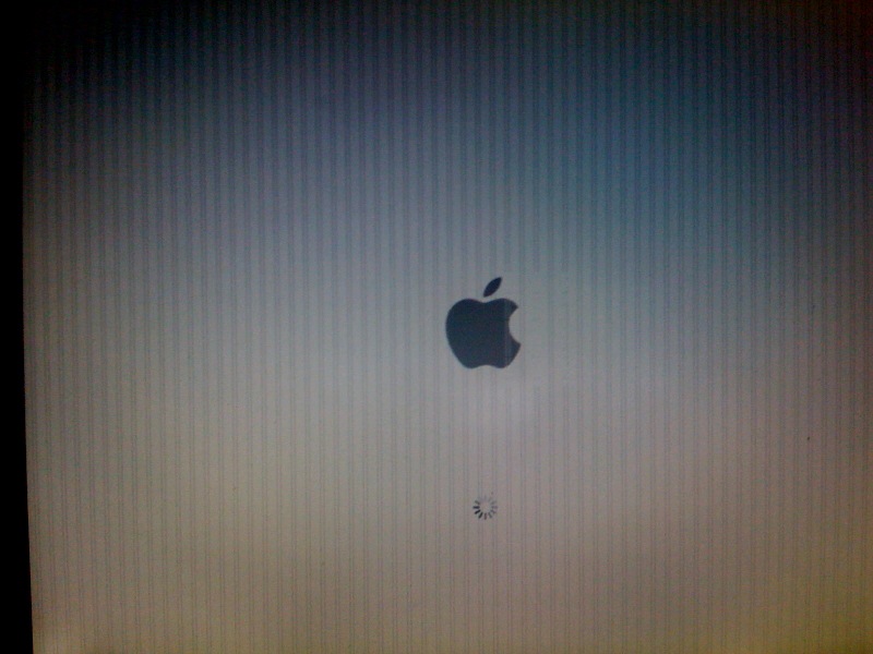

I have a 12" PowerBook G4 1.5ghz. I have had zero problems with this computer until just a few days ago. All of the sudden it froze. I manually shut it down. Waited a few minutes and tried to turn it on again. All went normal, however, at the boot screen the spinning wheel under the apple all of the sudden stopped. I tried again - same thing. I tried booting in safe mode - same thing. I tried verbose mode - same thing. I booted in single user mode and did /sbin/fsck -fy as well as /sbin/fsck -fn until it said that there were no modifications. Tried to start it up again - same thing. I plugged it in to my new iMac and put it in target disc mode. From here I went into disk utility selected the drive and repaired the permissions and disk twice. Tried to restart - same thing. Tried resetting the PRAM and you guessed - same thing. I used my friends MBP OS X disc to try and boot from the disc and got the same frozen wheel under the apple. At this point I thought there was something terribly wrong with the hard drive so I replace it with a brand new one. Thinking I was made in the shade I try and boot from disc and got the same thing! I have tried to read other forums and do suggestions but they have gotten me anywhere.

Sounds like either the fan has failed or on it's way out. Or the logic board is about to die.
When I do start it up the fan does make a 2 or 3 second loud sound. Almost like it is turn on power for that brief period of time. At the same time when it was in target disk mode there were lines every 3mm or so apart. When I do start it up to the boot screen there is no signs of lines. Thanks for your response!

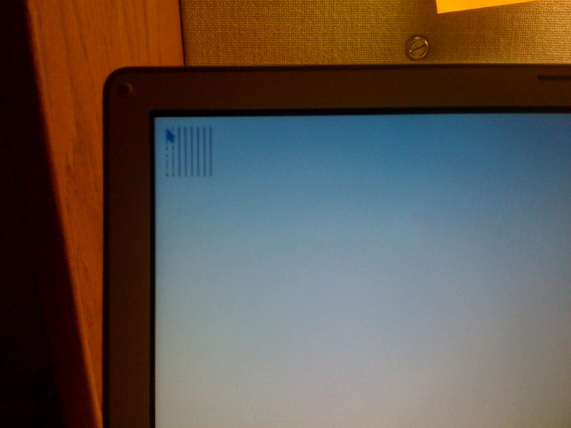

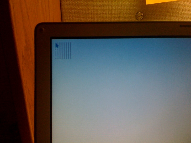

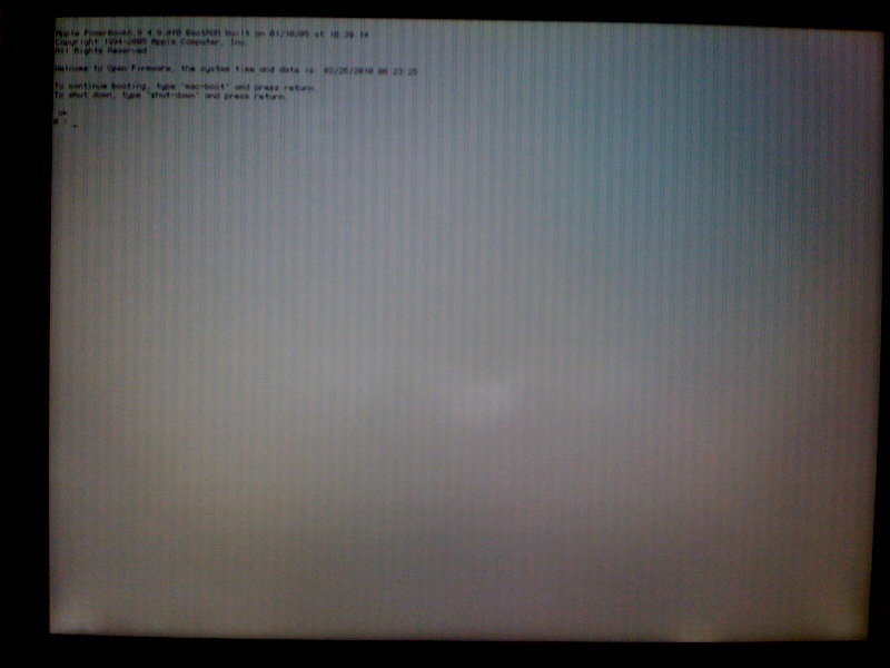

After I unplugged the bluetooth and hard drive and got the blue than grey screen I plugged in the hard drive and it booted fine! Everything looks normal all my files are there. I went to go do disk repair and after about 15 minutes it froze with the spinning beach ball of death.Thinking it was because I had the RAM out I reinstall it and boot it up. Booted fine again! Same thing happens 3 or 4 times. Finally I decided to just boot from the disc and do a zero data on the drive thinking this may help. It finally boots from the disc but as I go to select my language it friezes. Not with the beach ball but with these lines coming off my mouse. So I restart it and it goes and does its frozen wheel again. I try again - same thing. I pull out the hard drive. Same thing. Try booting from the disc and I get the boot screen with lines in it. After that it goes to a blue screen where I get the mouse with lines coming off of it and freezes. I shut it down boot in the command line to reset-nvram, set-defaults, and reset-all. These lines come up again. I do what I came to do. It reboots its self after reset-all and comes up to a clear boot screen that freezes on the wheel. I reboot same thing. I boot from disc same thing. I boot holding option and out come the lines.
Is this showing death of the logic board? I have no idea what it could be. When it did boot everything work awesome... until it froze.
This is starting to sound like a logic-board problem. It's hard to say definitively, but given the lines on the display when it freezes, it could be voltage regulation/bad DC-DC Board or dry solder joins.... somewhere, or an over-heating/failing GPU.
You might want to try disconnecting and reconnecting any remaining connectors, and removing and reseating the DC-DC board.
Shame, the 1.5Ghz 12" is not such a bad beast. The dis-assembly gets worse from here, and doesn't really facilitate better troubleshooting at all. Unless you want to spend $$$ on buying another 1.5Ghz cheaply (perhaps with a cracked display), there probably isn't much more you can do. 🙁
