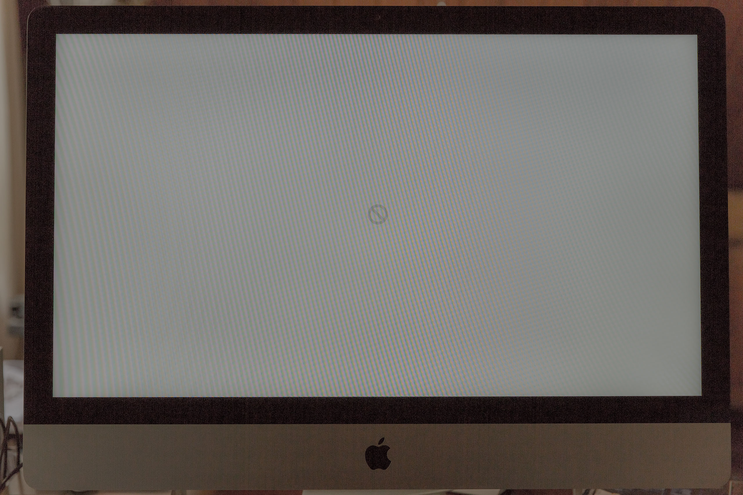

As a follow up and background information for anyone watching the thread . . . .
Things did not go so well. I ended up with the screen shot below . . . .
I ran the extended Apple Diagnostics, "No problem found".
Turns out it must have been a software issue, well, yeah, I know that now. This screen was precipitated with spontaneous shutdowns and failures to boot.
After a wonderful telephone call with Michelle at AppleCare, problem resolved, quite possibly for good. She shot me a couple of Apple articles articulating procedures to engage if it goes pear shaped again. We ended up booting into the Recovery Partition, going into Disk Utility (which was the Yosemite DU) and running "Verify Disk" and "Repair Disk", then restarting.
That resulted in me logging into my Yosemite desktop and everything is right with the World. Yaaay, life is good.
