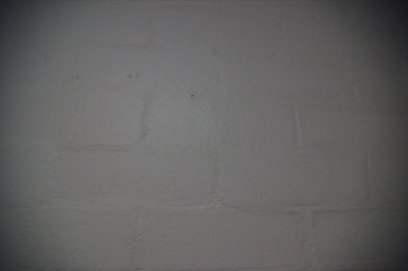

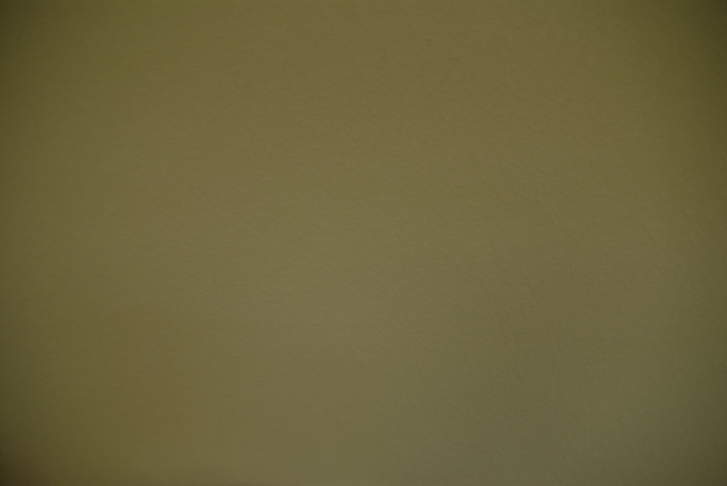

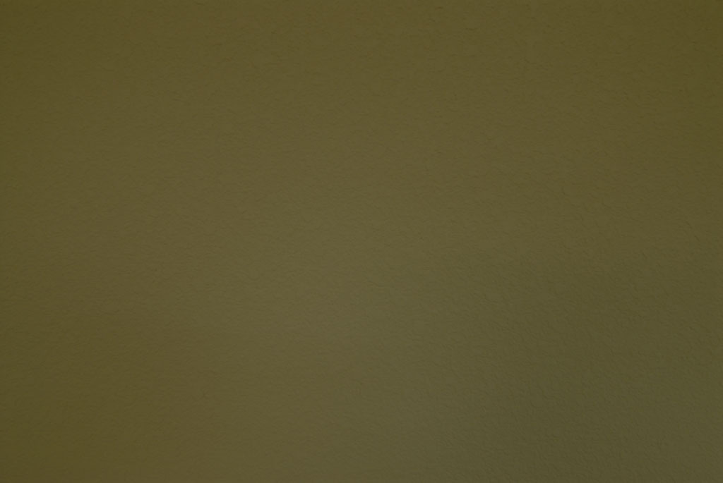

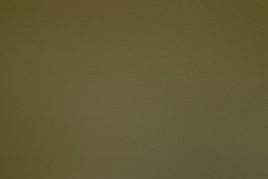

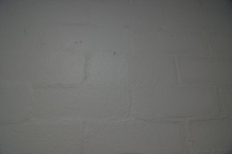

Can someone tell me whether the following photos show an unusual amount of vignetting? 😕 ALL the photos were taken with the UV filter on except the very last one to show you that the filter isn't causing any issues.

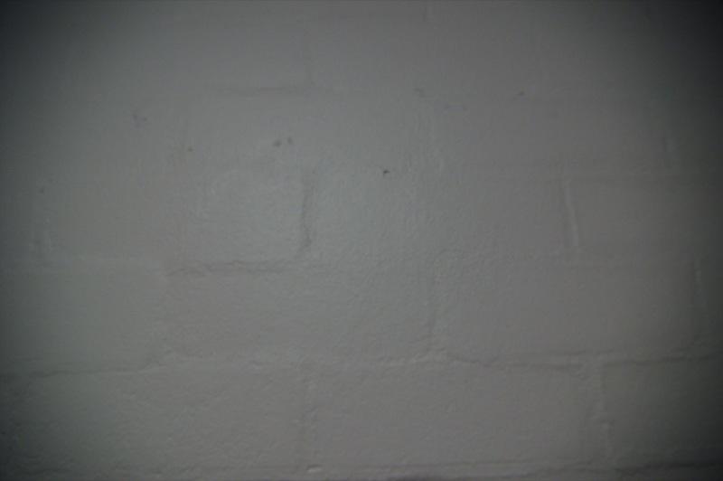

Using the 12mm at f/4 with no filter attached. I read a few reviews for this lens at SLRgear before purchasing, and nobody ever mentioned anything about vignetting, only that there was CA. 😕
  • 12mm f:4 with no filter.JPG
That's not normal. My Sigma 12-24 never did that. CA I would expect, but that - no.
I think Chip has one of these, maybe PM him?

EDIT TO ADD: Just wanted to say that this vignetting seems much worse when the focal distance is short. All the photos taken so far was at a distance of around 30-40 cm. I tried taking photos of the same wall from at least 1 metre away, and the vignetting wasn't as bad. Is there a technical explanation for this, because I didn't know that vignetting depended on distance. 😕
I agree with Gary, this does not look right and is not normal. I think it might be a good idea to return to the dealer from where you bought it and ask to try another one on your camera to see if the same thing occurs. It may just be a faulty copy of that lens....
All wide angle lens do this to some extent. They all have a brighter center than edges. Some are corrected so you don't notice. It has to do with the geometry of maping the image to a flat sensor or flat flim plane. On a good lens this shouldn't be noticable.
When you add a filter or a lens hood some light might be blocked. They make filters specially for wide angle. These have very thin metal rings and no threads on the front. Some of them are even made of thin glass. You should hunt down one of these special filters if you like using filters. I wouldn't expect a "normal" filter to work. A step up ring might ork too. Get a very large filter and a steep up ring. You would need this for a polerizing filter as they don't make thin pol. filters
As for the lens hood, I'm surprized they shipped a hood that would vignet the image. It must be a compromize and they expect you to remove it at the wideist zoom setting. Hoods aren't effective at extream wide setting anyways. Best to use a hand held sheet of papera or whaterever
You can remove the dark edges in Photoshop (or in some other editor) as long as the edges are not completly black. The trick is to make a mask, one that is dark in the center and lighter on the edges. Make this by shooting the sky or a white wall at various zoom settings and f-stops then "invert" them to make a black and white negative image. Use this as a layer in PS and multiply the image to be corrected by the mask. If the mask was made at the same settings as the image the correction should be nearly perfect. You only have to make and "tune" the masks once and you can re-use the work as long as you own the lens. But a _think_ PS has a built in filter that will correct this. It would not be as good as a custom mask but maybe good enough
Also, If you've ever read "The Print" by Ansel Adams he claims that almost every image that is to be mounted on a light mat can be improved by very slightly darkening the edges of the print. He used black cardborad in the enlarger beam but in your case you get to have the effect (4x stronger then need be) for "free".
Lastly, Tokina is one of the lower prices lens makers. You have to figure there is a reason they are selling at the price they do. To fully correct this problem would require larger diameter lens elements and higher cost.

@ksz: The vignetting on my photo at 12mm f/4 when my wall was only 30-40 cm away is much worse than the vignetting in your photo, but at greater distances, maybe it'll perform more like yours. Again, I'll find out when I'm out in the park. I'll shoot the sky and see. Vignetting shows up great when shooting blue skies. 😱
