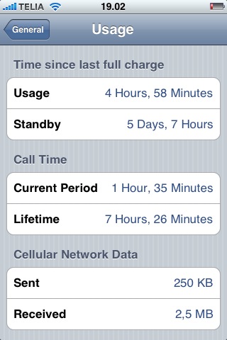

I had decent battery life with 2.0.2. After installing 2.1, the battery was down to red after 12 hours (out of which I had been sleeping for about 9), and reported 10+ hours of usage.
After that, I made a habit out of rebooting the phone regularly to kill all apps (you shouldn't have to, but it's the only known workaround), and now the battery life looks like this:

It's easy for me to get 5 days because I also have an iPod Touch, so I can use that one for all the fun, power-draining stuff while leaving the iPhone on standby. They do advertise 250 (or was it 300?) hours of standby time, and 250 hours is over 10 days. But in order to test if that's even possible, you'd have to leave your phone on standby, switch everything off except EDGE, never use it for anything, and hope that nobody calls in up to 10 days...
Note also that temperature has a major effect on battery life. I live in Sweden where it's fairly cold, which is a good environment for Li-Ion batteries... people who live in California and hang out on the beach all day will have short-lived iPhone batteries.
