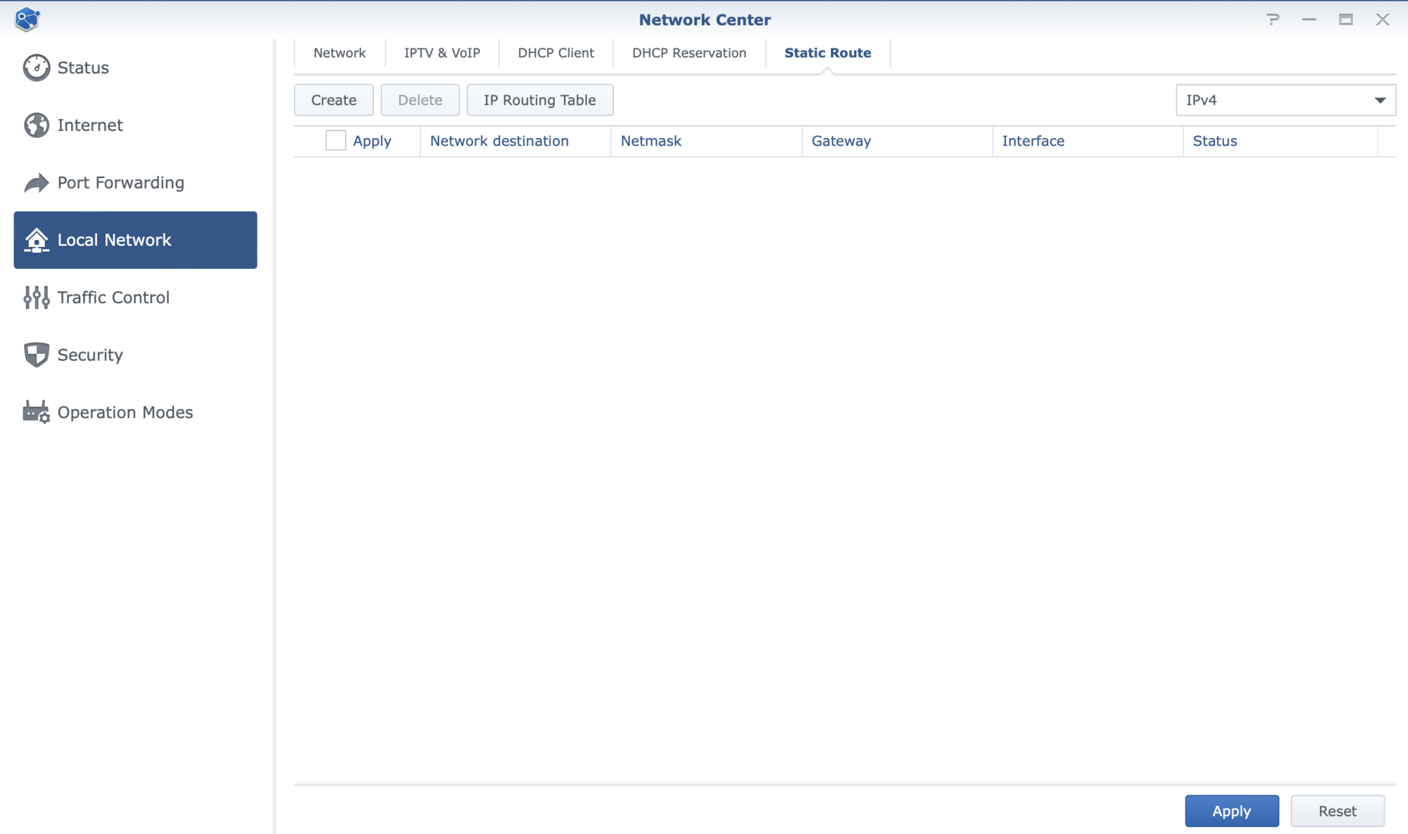

In SRM if I go to Network Centre/Local Network/Static Route/IP Routing Table, there's an entry in there with the following settings:
Network destination: 118.0.0.0
Gateway: 0.0.0.0
Netmask: 255.0.0.0
If I'm understanding this correctly then it seems that the router thinks everything in 118.0.0.0/8 is on my local network and therefore requests don't actually hit my Internet connection.
Does anyone know how I can change this entry and tell the router that it should only be my single IPv4 address, not the entire /8?
Interestingly if I change from DHCP to PPPoE then the rogue entry either disappears or changes to the single address (I didn't take a screenshot and I don't fancy changing it back), and everything then works as expected, so I do have a workaround, but it would be nice to get everything working over DHCP if I can.

I've just done a factory reset (so it's back on 192.168.1.0/24) and right out of the box that 118.0.0.0/8 route is still there.
I am on the Synology 2600, but same firmware, and mine shows nothing in that pane. What happens if you just remove that entry?
