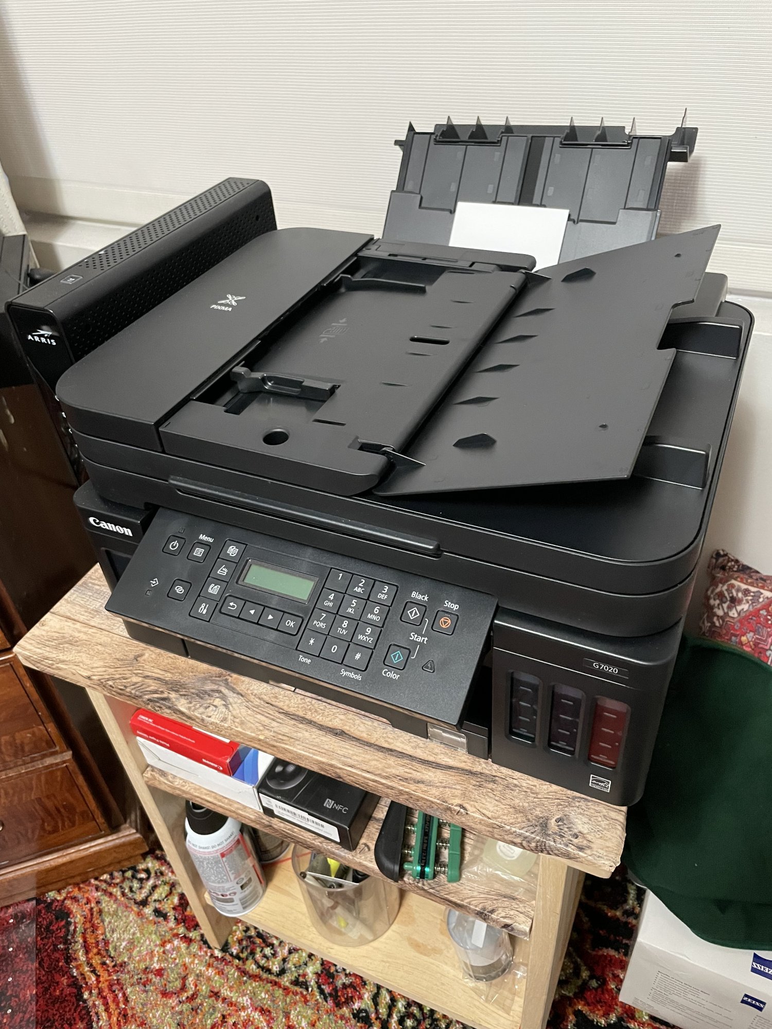

I read your other longer thread about your issues with a Canon printer, but just to give you a heads up,I have a new canon G 7020 air print (No Canon drivers) printer with my Mac Studio Max w/ the Studio Display and everything is working very well. I’m only using 4 x 6 prints right now, but the colors are very good. Sorry for your issues.

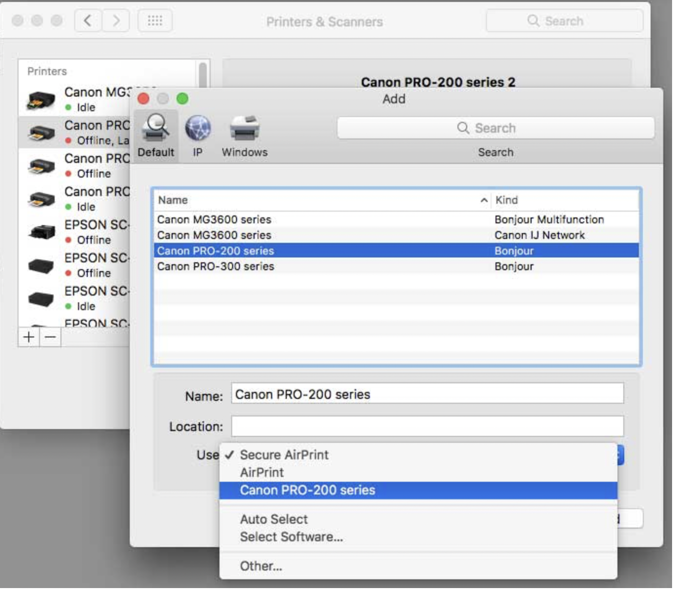

just out of curiosity, during the printer setup of the TS6300, are there choices available other than AirPrint and Secure AirPrint?

View attachment 2007954just out of curiosity, during the printer setup of the TS6300, are there choices available other than AirPrint and Secure AirPrint?
The only option I have is air print. I found a printer cable I used with a previous model and was able to plug it in and have it recognized, but the connection still says air print.
I found an old printer cable and hooked it up. The USB option then appeared in my selection , but even when I select it my printer still says air print. I downloaded and installed drivers from the website. They are for the TS 6320, but are in the same series. The only options, even when I hook up by cable, are Bonjour Multifunction and USB. Does not matter which one I select my printer is stil connecting via air print.
