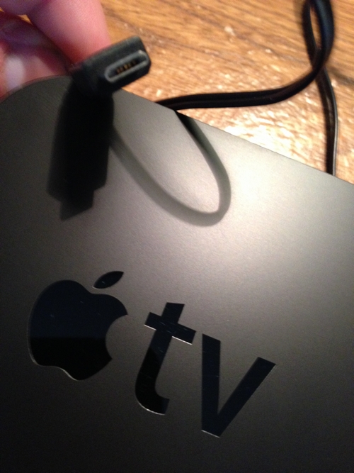

I got excited when I found this phone charger. I then went to plug it in my computer and noticed it had 2 prongs on the end. Fail. Now my Apple TV shall sit for a while.
