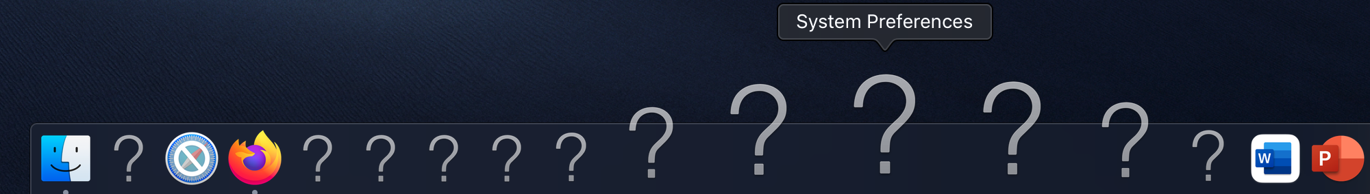

1. The system apps in the Dock are replaced with a big question mark and not working (see the image below). Safari tells me that this version requires Catalina (Obviously, I backed up my system after installing catalina and doing some updates). But now it seems that I need to revert to the older versions of these APPS

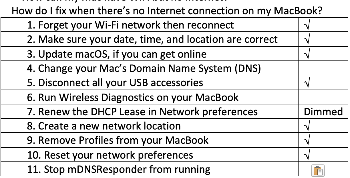

Or reinstall Catalina and then restore Time Machine backup to get all of your and Apple's apps working again (and try to get WiFi working one more time - here's a list of standard things to look at https://appletoolbox.com/solved-macbook-connects-to-wi-fi-but-has-no-internet-connection/). I recall on my 2015 MacBook Pro prior to 10.15.6 having lots of random drops, slowdowns, wifi connect issues, but wifi seem to be stable after 10.15.6/7.

Unfortunately, I did most of those suggestions in your link (the ones checked, didn't work). The option of DHCP renewal is not available (dimmed).
I am just afraid that I upgrade to Catalina once more, then go through this hassle again. (I am worried that I would have to reinstall again, to have the system apps)o_O
BTW, I was using Catalina 10.15.7, when I had that WIFI issues. WIFI used to work fine after reboot, and until going to sleep. Then I'll have to reboot again in order to get wifi working again.

To address the "? in the dock"...
This is EASY to fix.
Nothing to get upset about.
First thing to do is to GET RID of those question marks.
- CONTROL-click on each one, and observe the contextual menu that appears.
- Choose "options/remove from dock"
- The question mark should disappear
- Repeat for EACH and EVERY question mark.
But... now your dock is empty.
We need to fix it.
OK...
- Open your Applications folder in the finder
- Locate an app you want in the dock (but is now missing)
- Just "grab it" with the mouse, and "drop it into" the dock.
- Do this with each app you want in the dock
- When all are there, move them around into the order you like best.
Try this.
Does it work?

I'll tell you after I try. Thanks for this -too simple to think about- idea. But I'd guess that the app will not be working (hence it didn't show on the dock). Any way, I'll come back to you
Well .. It worked for most apps, BUT ... hmmm

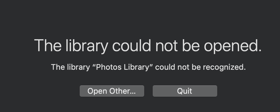

2. It didn't work with "Photos" app .. giving me the following error message:

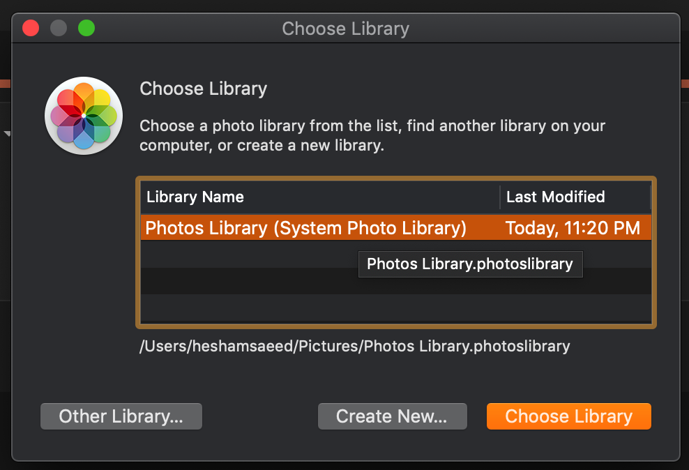

I tried with: Open Other ..., and I got the following message:
Choosing library sent me back to the same error. I chose Create New, and it's working now.
