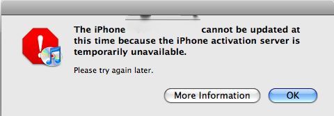

this is what I'm getting, anyone else?
glad I'm not the only one, it downloaded but now it's stuck here.
