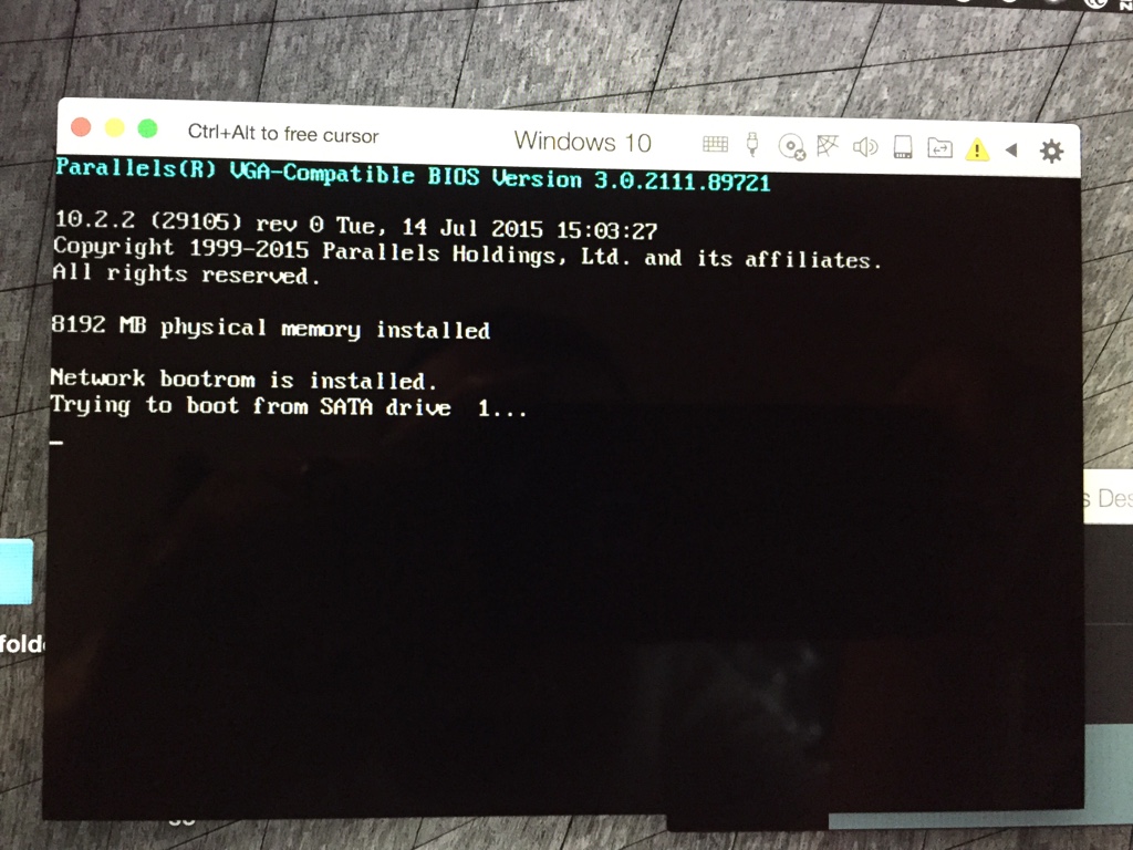

I had 8.1 installed on bootcamp partition and was able to use it in OSX but I did a clean install of Windows 10 on bootcamp but now I can't get Parallels to see it when booted into OSX. I tried following this tutorial:
http://bit.ly/1mwrjMs
But the install hung on this:

Hm...I found just this: http://kb.parallels.com/en/123072
Don't think it's right way...
I'm currently waiting on a reply from Parallels CS to get this situation corrected.
