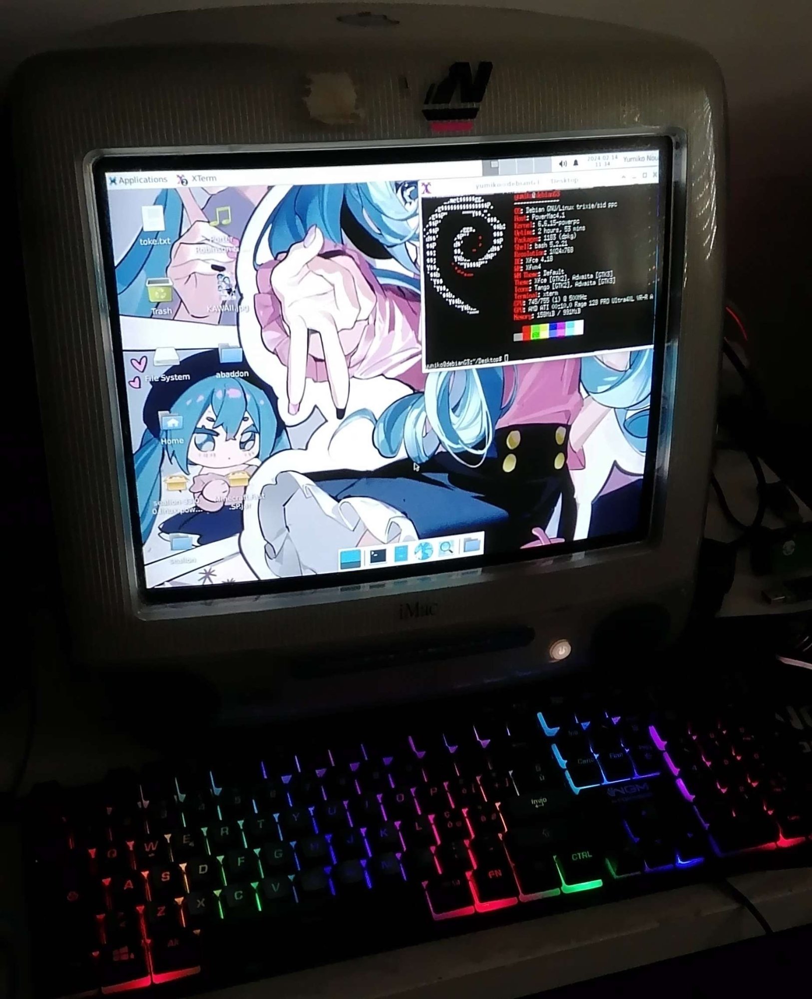

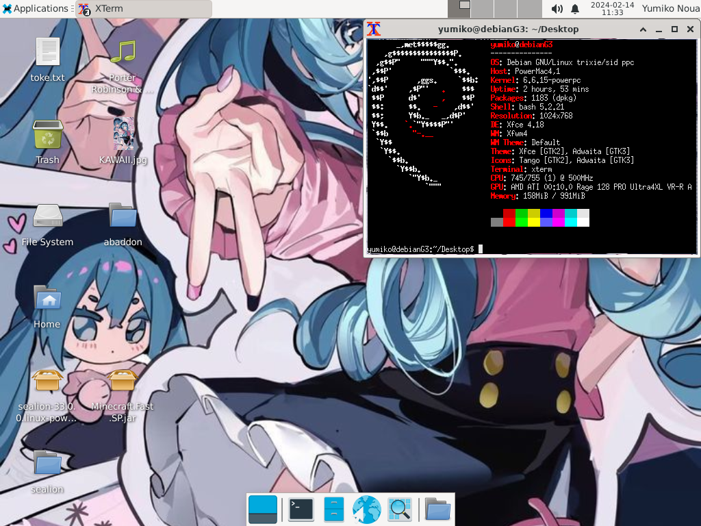

Hello, in this guide I will show you how to get the gui on iMac g3 with debian 12! here some example of it:
1)
2)
To get this we need to follow these steps:

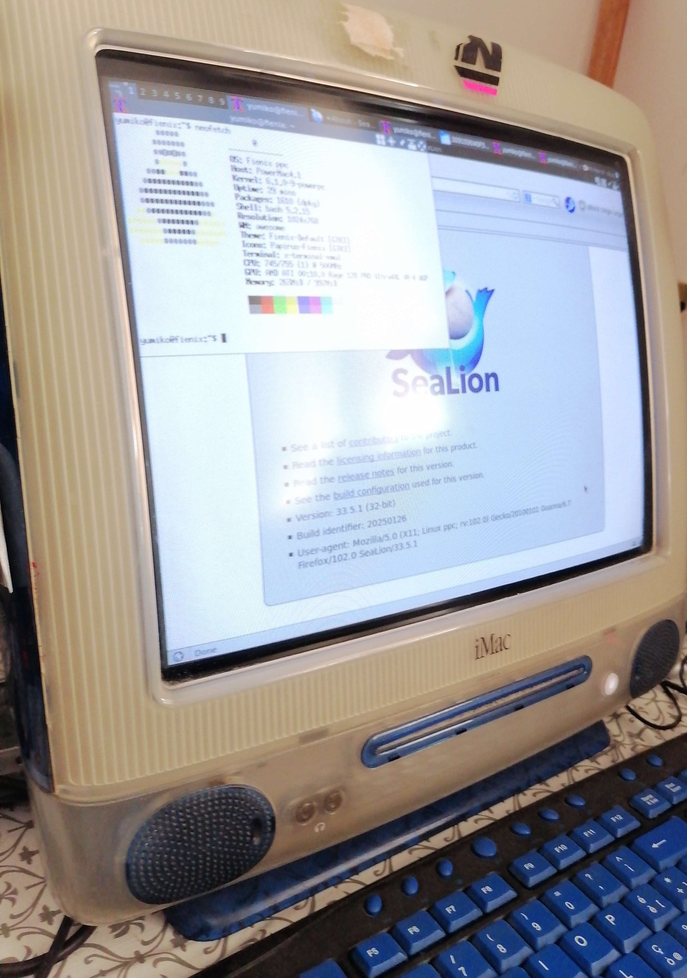

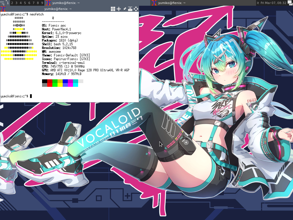

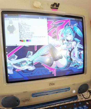

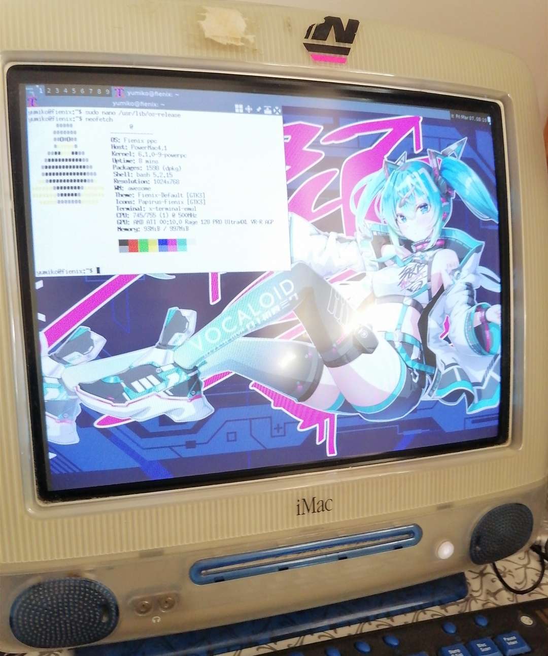

UPDATE: After a while, i got again Xorg working on my iMac G3, the method is the same of the last time, but now I used Fienix distro (still a debian based).
So, after the installation of Fienix, i add some "modification" of the desktop environment (from MATE to awesome wm) with the debian ports repo(modify the desktop environment is optional), and after used my guide with the same method, I got the gui without acceleration, here some screenshot:
1) desktop

2) Sealion Browser
If I missed something or you have some doubts feel free to let me know!
