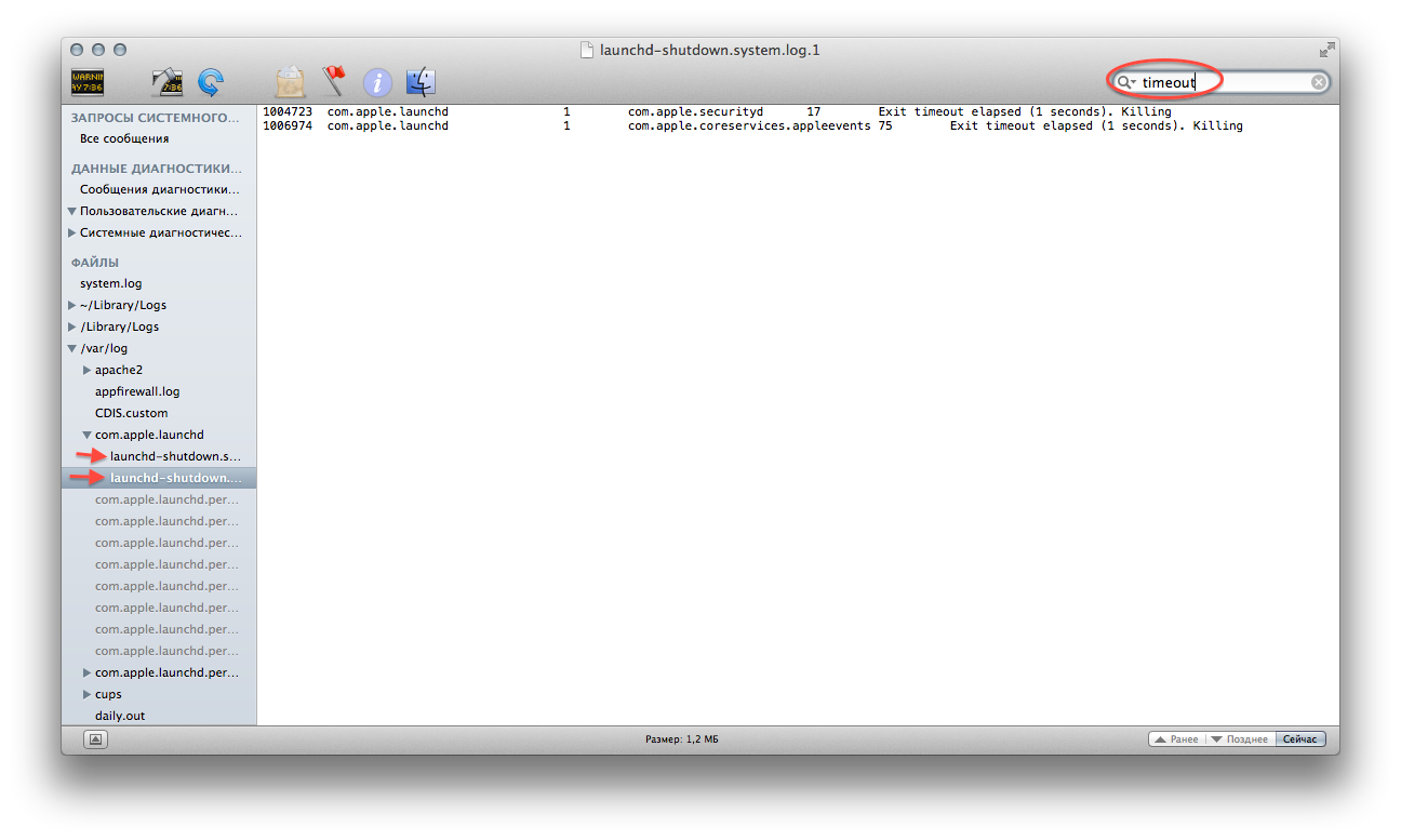

For me, this did not help
Thrash911, its impossible, because its a universal method and it works for every system) looks like you have done smthn wrong. did you paste those commands one by one and hit enter after each? and its very important to repair permissions right after terminal. and about console logs - you're looking in wrong place, see screenshot:

Andrea, you are absolutely right, im also noticin this service, and its definitely related to QT, but looks like there is no solution to fix it and we just have to deal with it for now..
