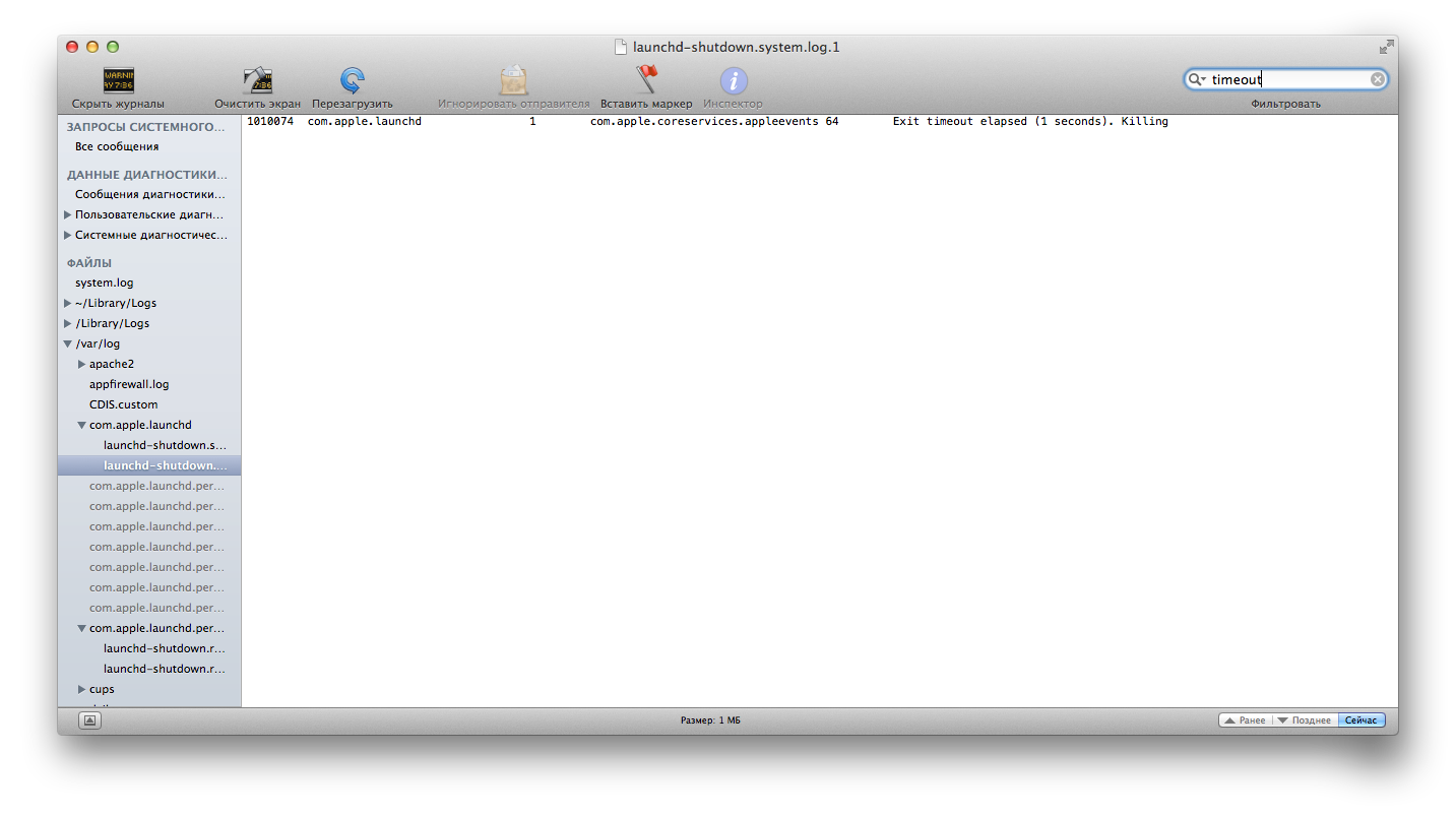

only appleeventsd here
Not just appleeventsd
I also had other services hanging on shutdown, but they were due to badly designed third-party drivers: I could track them using the same method (looking at the launchd-shutdown log) and I could solve them by just avoiding to load the associated kernel extension. I am saying this to highlight that appleventsd may still not be the sole cause, even though at present it seems the more likely and frequently observed.
Digging further into the problem
For some time I had some evidence that the AppleIDAuthAgent (com.apple.coreservices.appleid.authentication) was also hanging, but after further tests only appleeventsd seemed to actually slow down my poweroff sequence. However, during those tests on the AppleIDAuthAgent I could observe the origin of the problem: the agent just stopped handling the SIGTERM signal. The documentation (man page) of launchd.plist explains that, when a service is to be shut down, launchd first attempts to gracefully stop it by sending a SIGTERM: if the process does not quit spontaneously within the timeout, then launchd abruptly terminates it with a SIGKILL. So, what I did was to invoke the AppleIDAuthAgent "manually" (i.e., not through launchd) and run it through dtruss, a utility that tracks the system calls issued by a process. When I attempted to send a SIGTERM to that process nothing at all happened: no reaction, no system calls printed, no spontaneous exit. SIGQUIT and SIGHUP were instead processed successfully. And what was most strange is that this did not happen consistently, so it could not be ascribed to an overlook by the programmers that "forgot" to process the SIGTERM signal (which, also intuitively, looks very very unlikely).
I guess something similar could be happening with appleeventsd, but the true point is how to determine what makes it ignore the SIGTERM. Reading reports like this and this makes me prone to thinking it's really a bug, although I could not (yet) rule out potential third-party causes on my machine.
BTW, I am not using iCloud.
BTW again, when you use Console remember to look at the launchd-shutdown.log: the other file suffixed with a 1 is usually an older version of the same file that refers to the penultimate (i.e., not latest) shutdown sequence.
If you have a very slow shutdown time (+20 seconds) please open the Console app and check the system launchd-shutdown logs and search for the text "timeout" to find out which processes that are causing the slow shutdown. For me the problem is the securityd daemon and the appleevents services.
I had these:
20005100 com.apple.launchd 1 com.apple.securityd 15 Exit timeout elapsed (20 seconds). Killing
20007444 com.apple.launchd 1 com.apple.diskarbitrationd 16 Exit timeout elapsed (20 seconds). Killing
20007499 com.apple.launchd 1 com.apple.coreservices.appleevents 51 Exit timeout elapsed (20 seconds). Killing
