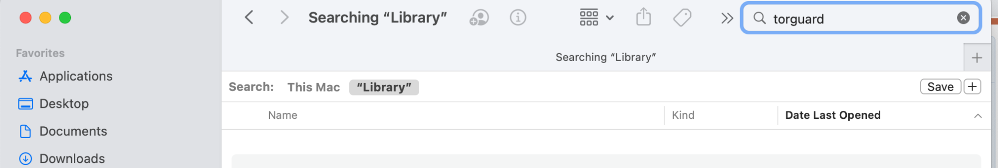

Yes, look for torguard. Open that Library folder's finder window and use the search in that window. If the search location in that window defaults to say, Macintosh HD or This Mac, just tap on the Library location next to it. Same with your user Library folder. You would think if (in the example below) searching This Mac would include the system Library, but it doesn't.
