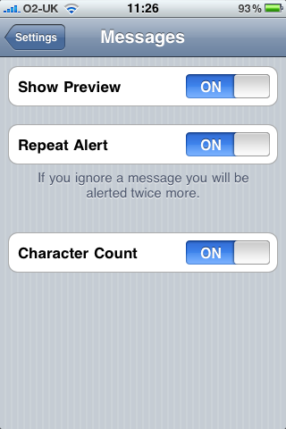

I have a 3gs, which was jailbroken before, i downloaded the new iSO4 GM and did alt-restore, everything worked well, except the MMS button on the in messages, and no MMS settings in the messages settings tab (image shown below).
If anyone has a solution, please reply back
