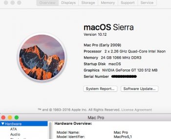

4,1 flashes to 5,1 works fine. Had an initial hiccup at the login setup. Booted drive externally to MBP. Did the initial setup and works fine inside MP.
my Mac Pro 4,1 was fw upgraded to 5,1.
Installed a Wifi AC + BT 4 card
running CAT enabler
macOS Sierra very happy :)
