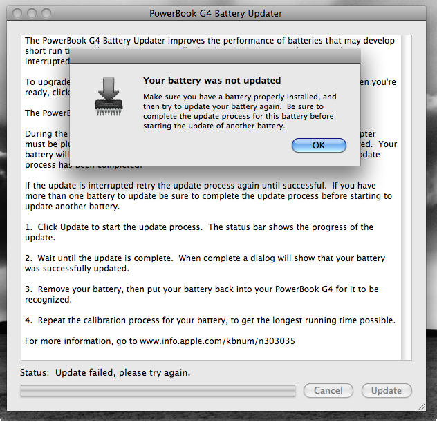

Applying the PowerBook G4 Battery Updater on OS X Leopard on an aftermarket battery returns this message:
I received the same message on a second aftermarket battery from the same source. Actually, the first time I tried the update, I received a "Your battery does not need to be updated” message.
I think this might be a good indication that aftermarket batteries do not contain the same microprocessor inside the battery enclosure as the original A1148 battery.
