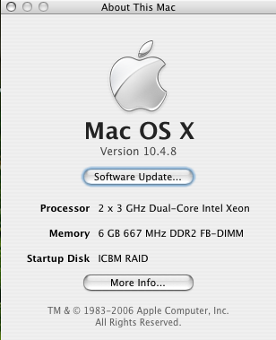

just for proof 🙂

I'm not sure what the 3.0's go for.. Oh Newegg has them for $856 each.
And yes, it voided my warranty on the CPU's... California law requires them to prove that the part replaced was the cause of any failed item that they are denying the warranty... I feel quite safe that if one of the remaining parts that I haven't replaced yet fails, I will be covered.
Lets see, I added a DVD-RW, replaced the stock 1GB with 6GB, replaced the CPU's, replaced the stock HDD... only thing left is the motherboard, power supply and ATI X1900. 🙂 and the X1900 I'm sure will be replaced once something better comes along. (No, I don't think the X1950 is worth the price to upgrade..)
