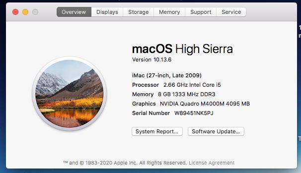

Already tried new GPU on my iMac 2009 and 2010, though. In my case I was cheap out and bought the original cards, heatsink from different sellers and did all the modding and flashing myself.
