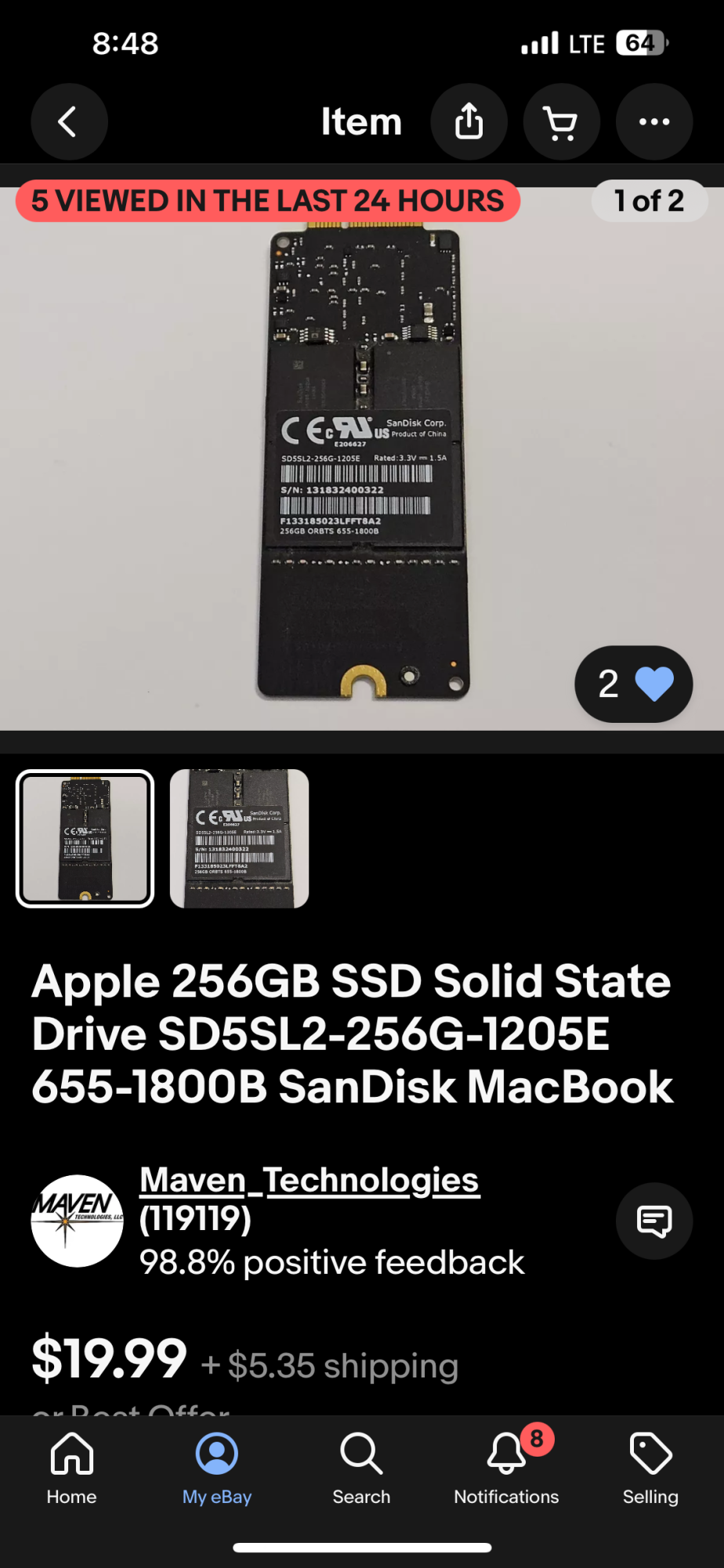

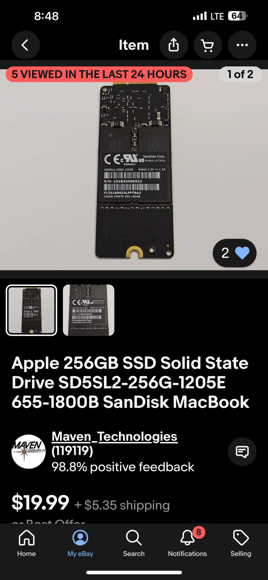

Great! Thanks for replying! Looks like I need to get an Apple ssd. Found one on ebay that says Apple ssd and it looks to be one of the original ones so I will try that.
This is what I'm thinking on buying
I went ahead and got it.
Wish it was available when I bought the Fanxiang ssd but it wasn't.
They don't seem to stay available for very long so I went ahead and ordered it.
I got the apple ssd from ebay but I can't seem to get the laptop to recognize it. I did the nvram reset but it didn't help. I tried another ssd caddy but that didn't help either. Any suggestions?

Does anyone know if the Sandisk Sd5Sl2 apple ssd is considered oem? It has the right pin configuration, meaning I don't need an adapter, but could it be my macbook doesn't recognize it because it's not a Samsung?
I can't speak to the 2012 MacBook but my late 2013 13" Pro, early 2015 Air 13", and mid-2014 Pro 13" would only accept the High Sierra firmware with an OEM drive inside the laptop.
K thanks!
The drive I have just won't work so I am going to try a Samsung oem drive and see if it shows up.
