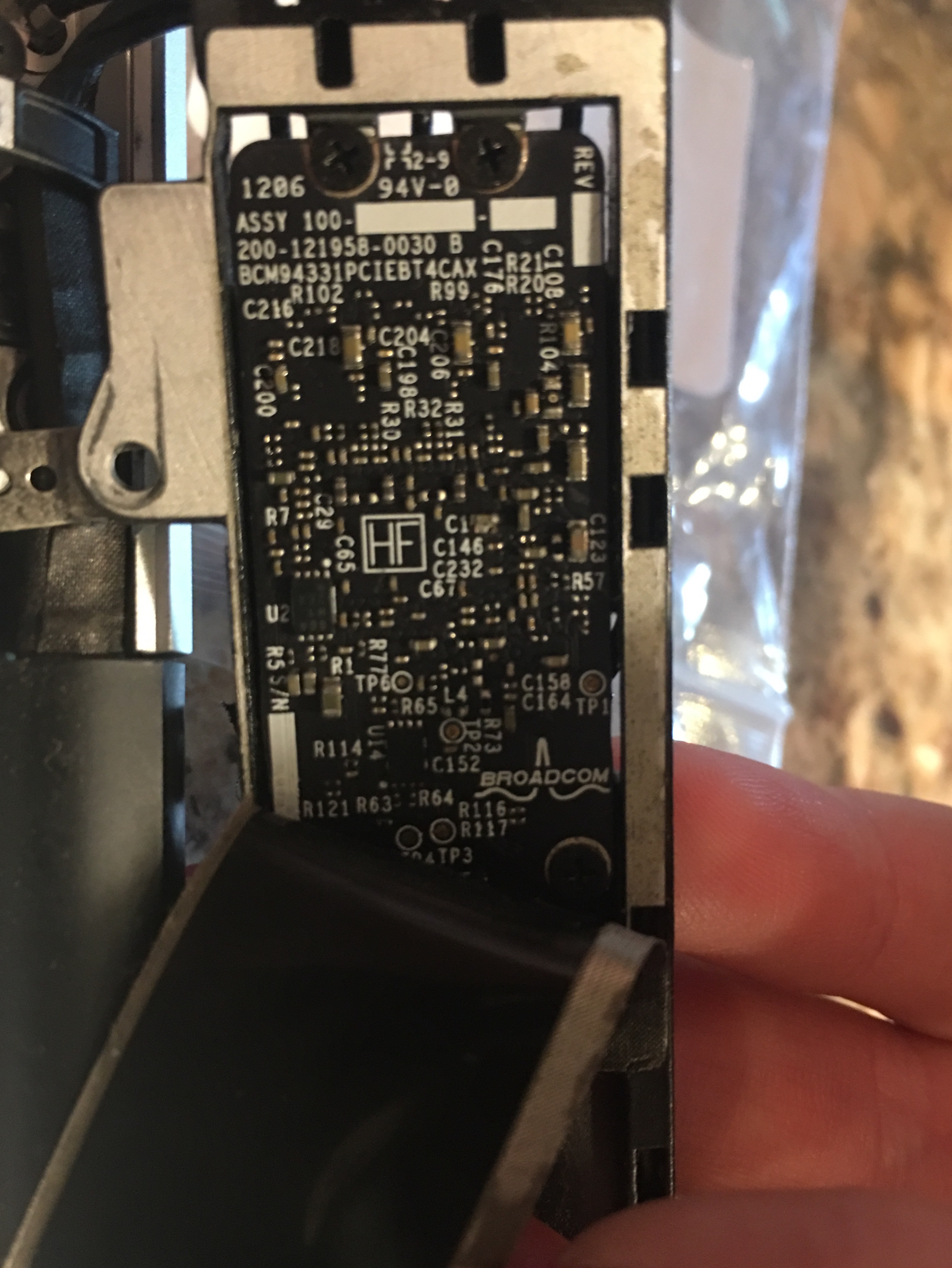

I have just installed an updated BT card (see pic) in my Early 2011 MacBook Pro 17".

I checked and rechecked the physical connections to the card
I am starting to wonder if there is something wrong with the card itself (I bought it from NewEgg - the inscriptions on the card appear to be correct)

Let us know how this all turned out. Before you give up on that card, make sure the antenna leads are in fact plugged in properly. That was a bug-a-boo for me . . . maybe you too?
