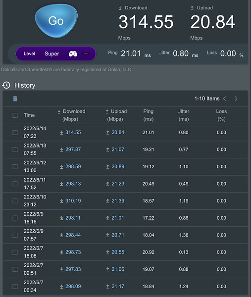

Hi MacinMan... I recently got the same router (ax86u) and am noticing that I rarely get full wi-fi speeds on my Apple devices (MBP, iPad, iPhone etc.). Just wondering if you notice anything similar?
My internet service is 300 down and 20 up. I verified that the router itself is getting the full speed.
Here is the router speed test:
And here are some speed test numbers from my iPad for example:
This is standing about 10 feet in front of the router. I'm just trying to determine if this is a wi-fi issue or an Apple device issue. Just curious if you are able to obtain consistent full speeds on your Apple devices?

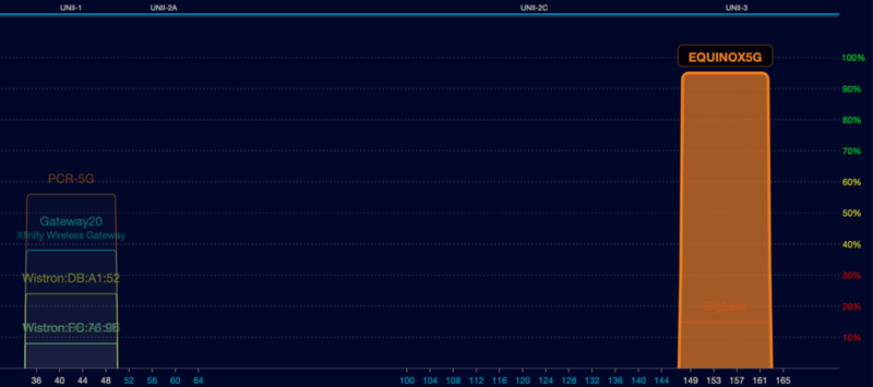

I assume you have a Mac, so download a free trial of WiFi explorer, if you don't own a licensed copy and look at the network around you to see if it shows any kind of interference or performance problems. Also, if you haven't already, try disabling WiFi 6 on both 2.4, and 5 G bands just in case it's causing issues and see if it functions as a WiFi 5 router without issues. If that fixes it, then you have an incompatibility with WiFi 6.
Well, and Canada has different wireless standards than the US as well, so might not be much help there. Yeah return it before it's too later, or ask Amazon for an exchange to try a second one (if you got it from Amazon)
Thanks, I'll give those suggestions a try. I've got a fairly clear 5Ghz band as shown in WiFi Explorer on my MacBook. My network is in orange:
OK, looks like you're ready to start troubleshooting with the tools and suggestions I've given you. I'll wait to hear back from you either way, if you're able to resolve the issues, or not.
Reactions: seadragon
Thank you again @MacinMan I seem to have resolved the issue with a simple channel change. I switched to channel 149 and I'm now getting full speeds. I'll see if it lasts but so far so good!
