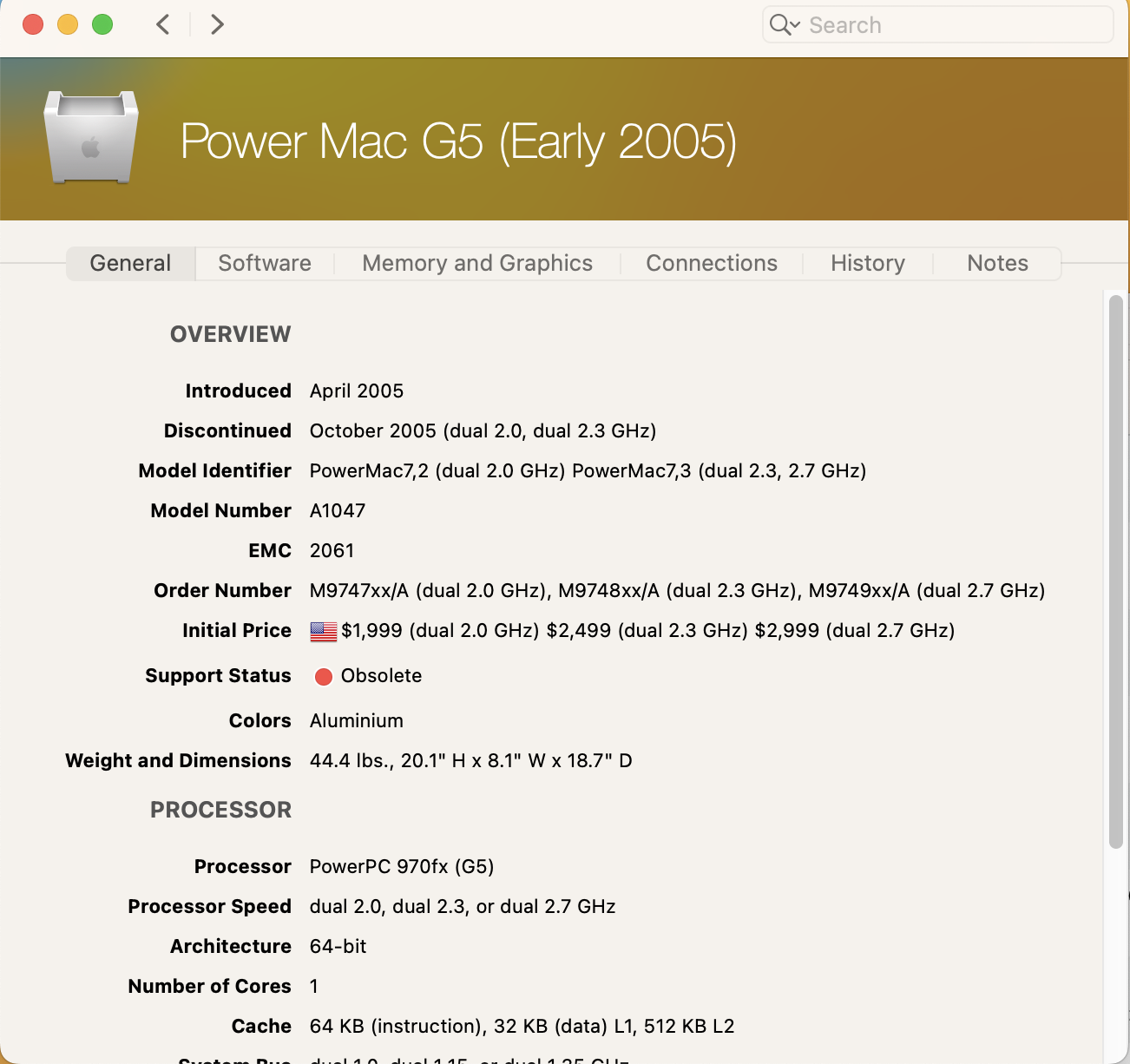

But the early 2005 PM 7,2 used a 970fx.
No. The early 2005 was a PowerMac7,3 and relied on a different daughtercard/logic board/Open Firmware setup than the PowerMac7,2 of 2003.
It may be possible, say, to try a 2.7GHz PPC970fx CPU assembly in the mid-2004 PowerMac7,3, but nothing from prior to the mid-2004s did the PPC970fx see use.
Note: the above reference to early 2005 G5s is incorrect. This is the correct info for the base model early 2005 PowerMac7,3.
If you are brave enough I'm pretty sure the 7,2 and the 7,3 models share the same case design. You could (in theory) swap out the logic board in the 7,2 for a 7,3 logic board and install single/dual 2.0/2.3/2.5/2.7 970fx CPUs in it. I'm not too sure about power requirements though, you may need to swap out the PSU for that.

A very good question. As others have stated, I wouldn't count on the 7,2 from 2003 being compatible with the 970fx CPUs from the 2005 7,3 model - but I can't say for sure, as I haven't tried this myself and I have not held these two CPUs side by side to determine if they are physically a match or not. So, buying the parts expecting this to work would be a gamble.
