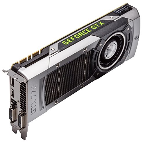

Looking to upgrade the graphics card for my mac pro. Currently running the GT120, which is old but is a very quiet card. Anyone know of a nvidia card that won't be too much louder that the 120. I know they will be but trying to keep it as quiet as possible. Looking for GTX770 & up.

A GTX 680 is much more suitable for a Mac Pro than a 770 because the 680 can be very easily flashed with a Mac EFI ROM. Performance is about identical.
My 680 was very quiet when idling. At full load there can be some fan noise but it is not loud in my opinion unless you are working in a very quiet environment.

I will say that the 680 is easy to flash for Mac, the 7970 is flashable but much more involved process, and I don't think the 960 is self-flashable at the moment.

Maxwell cards are very quiet--nowhere close to wind tunnel. The 960 and 980 have been featured on SilentPCReview.com, a website dedicated to quiet computing.
At idle my GTX980 doesn't even spin its fans at all. EVGA had to include warning stickers telling owners that it is normal for the fans to not spin, so that people wouldn't assume the cards were defective and return them.

Hey ActionableMango.....Got the GTX770 also. I have two 6 pin cables for the 7970 in one of MPs. So I need another 6 pin for my other one for the 770. If I remember correctly the 770 is about the same as the 680 so I think I can run it with 2 6 pin connectors, right? So where would be a good place to get one except OWC or china. Not really interested in paying $18 for one because it's from apple or waiting for a month for one from china. If I do need a 8 pin to run from the sata connectors where can I get both from the same place? Any thoughts?

It should run on 2x6-pin connectors unless it is an unusual model.

No, you cannot flash the 770 with the 680 ROM.
The vast majority of 680's with an 8-pin socket work fine with a 6-pin cable plugged in, no adapter. A couple of 680 models that are very far from reference do require an adapter.
I have no experience with the 770. Most people around here get the 680 because it's the same speed and can be flashed for Mac support.

Hey Action...........glanced back at the post & thought I might clarfy it. I know you can't use the 680 rom but was wondering if the guide for the 680 would be the same guide for the 770 but with the 770 rom. Is that right or am I still wrong?

I've never seen a Mac 770 ROM available nor heard of anyone flashing one DIY style. I suspect the procedure would be similar, but I don't know.
No I haven't either but haven't really looked that hard. I'm sure one can be located though. I know macvidcard can flash them. Might go that route if can't find anything for it. Thought I might give it a try. Only have $50 in it so not much to lose if I mess up. I do have my 7970 as a backup card.
