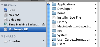

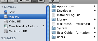

Okay, so I found something strange. The contents of the new drive seem to be different than the contents of the old drive. I'm missing a few things on the new one, such as "home" and "net".
anything to be worried about?
Old drive first...
Old drive first...
I renamed my Carbon Copy to Mac Pro HD (replaced the 320GB with a RAID 0 1.5TB) and just looked (don't have the Macintosh HD to cheek against) and I don't have the home and net folders either. What files do they contain?
Those directories don't exist by default. They were created by the OP for his machine.
