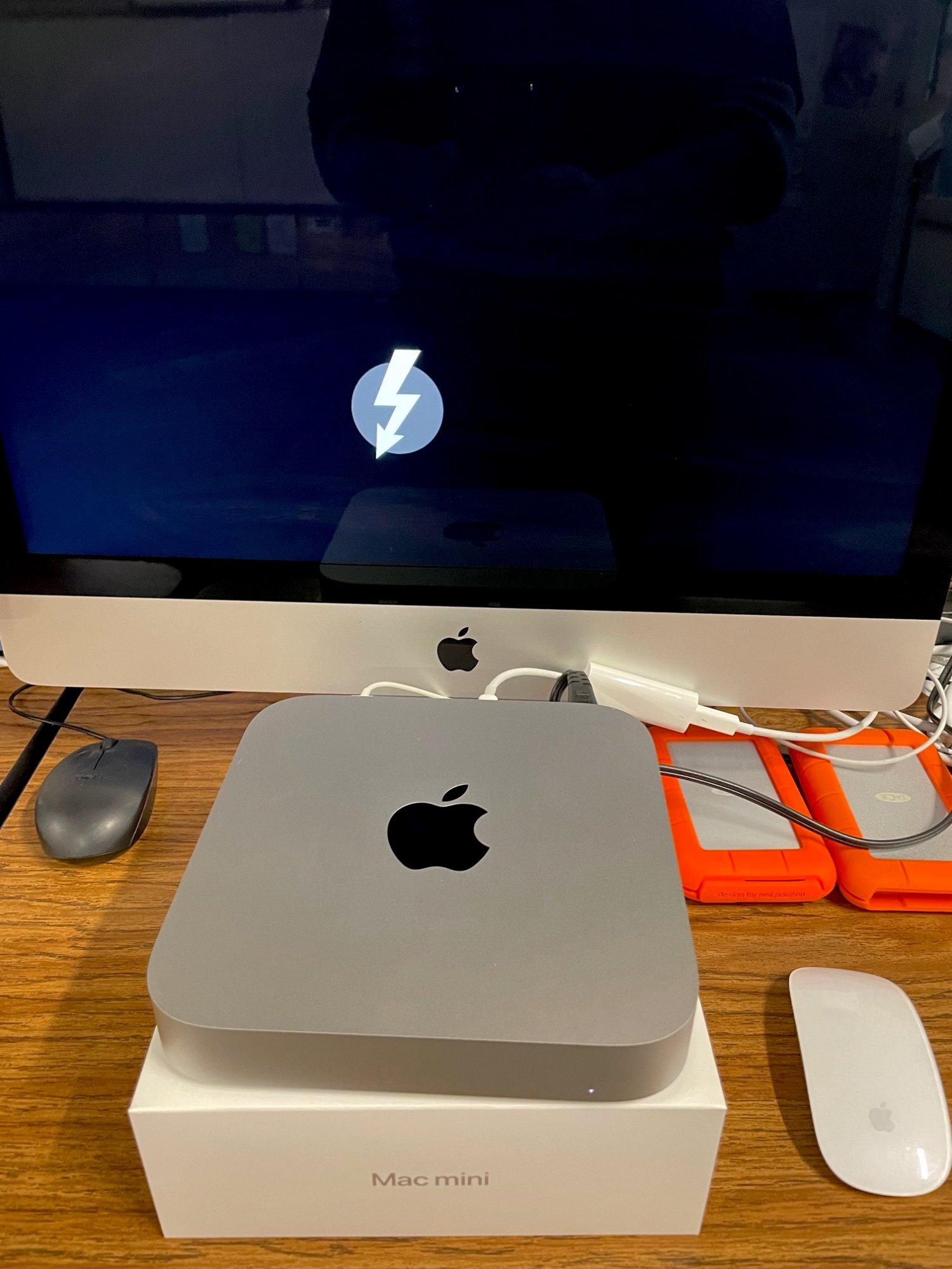

How did you get your iMac to work as a target display ?
I can't get the M1 Mini to work with a 2013 Pre Retina iMac.
I am using the Apple TB3-TB2 adapter to make the connection between the USB-C port of the M1 to the Thunderbolt 2 port of the iMac using a .5m Apple Thunderbolt cable.

You're in "Thunderbolt Disk Mode" - Apple has never supported Target Display Mode at the same time as Thunderbolt Disk Mode. You have to be booted in to the OS on the iMac to use Target Display Mode.
And I wasn't able to get Target Display Mode working with the M1 Mini. Only with my Intel MacBook Pro. Apparently the M1 Mini doesn't support outputting video to Thunderbolt Target Display mode. (If you have an older pre-Thunderbolt iMac that supports Target Display Mode over mini DisplayPort, it should work, since there is no Thunderbolt negotiation going on there. But for a Thunderbolt iMac, it looks like TDM isn't usable from Apple Silicon Macs.)
