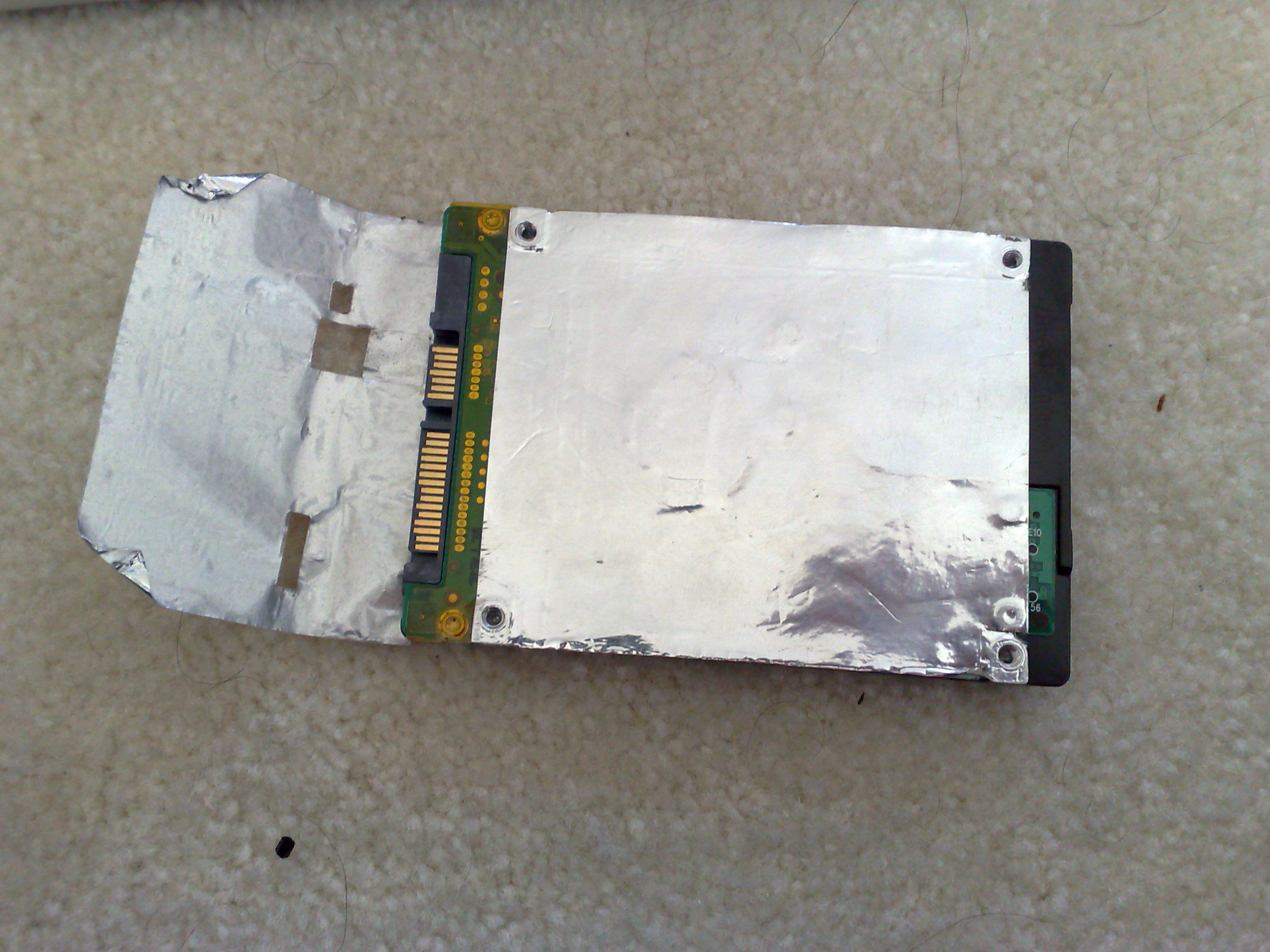

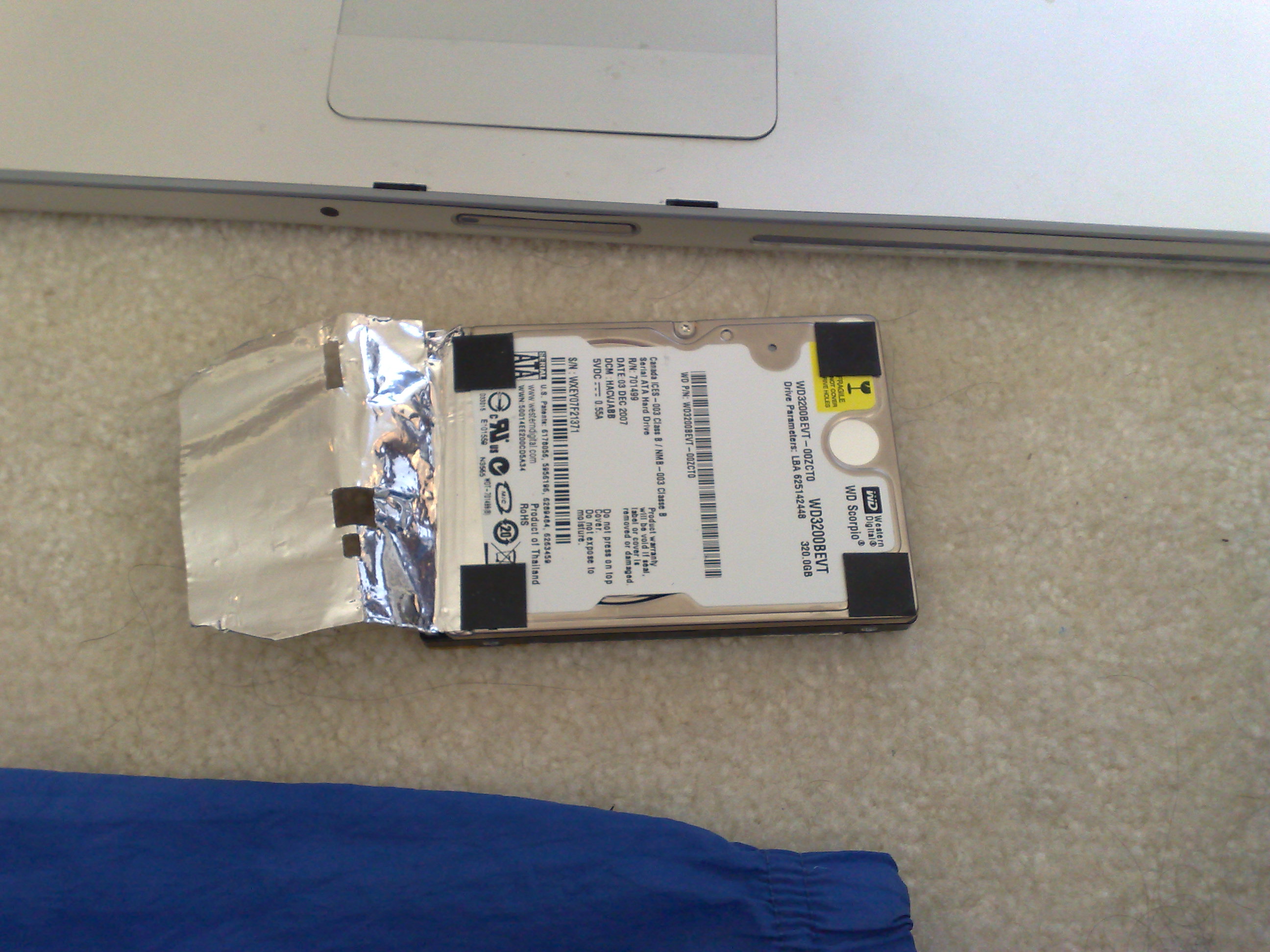

The foil that's on my WD3200BEVT (because it was from a portable external hard drive)
The WD3200BEVT I'm going to be putting into my 15" 2.2ghz MacBook pro is from an external drive so it has some foil on it and some rubber square things. anything special in removing these before I put the HD in my hard drive? Or should it not be a big deal. Pictures attached
Remove the foils and everything extraneous and put the bare drive back in - there should be no issues.
