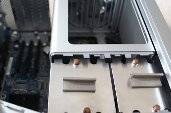

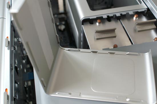

Something else you should maybe know. These sites that show an image for every step and comment on the difficulty level are very misleading. The upgrade really is as easy as opening the machine and replacing the processors. The only weird part is popping off this cover:
Which kinda lifts up-over-out inward. 😛 It'll make sense when you're in there. 😀
Also, really all that's needed to remove the heat-syncs is a standard allen-wrench. 🙂
