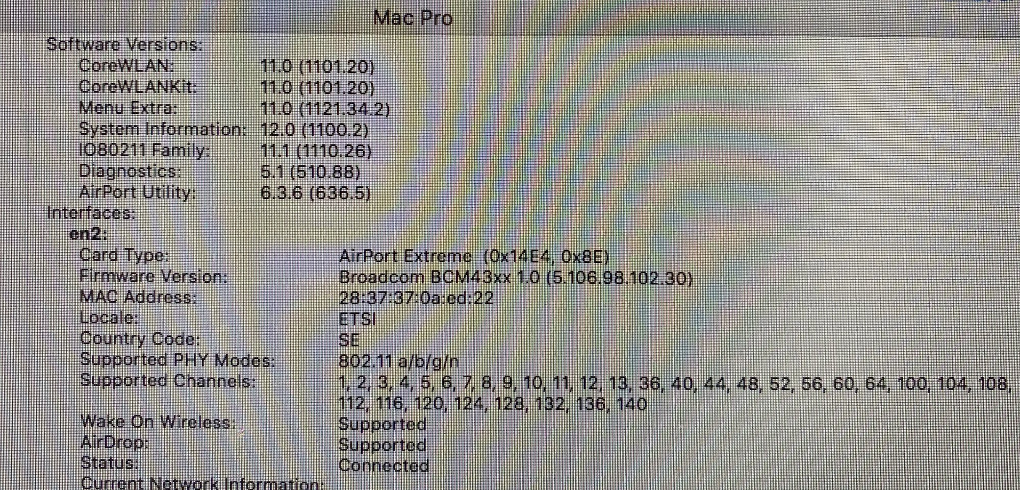

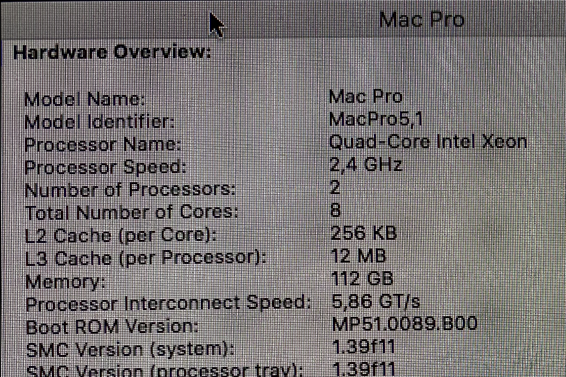

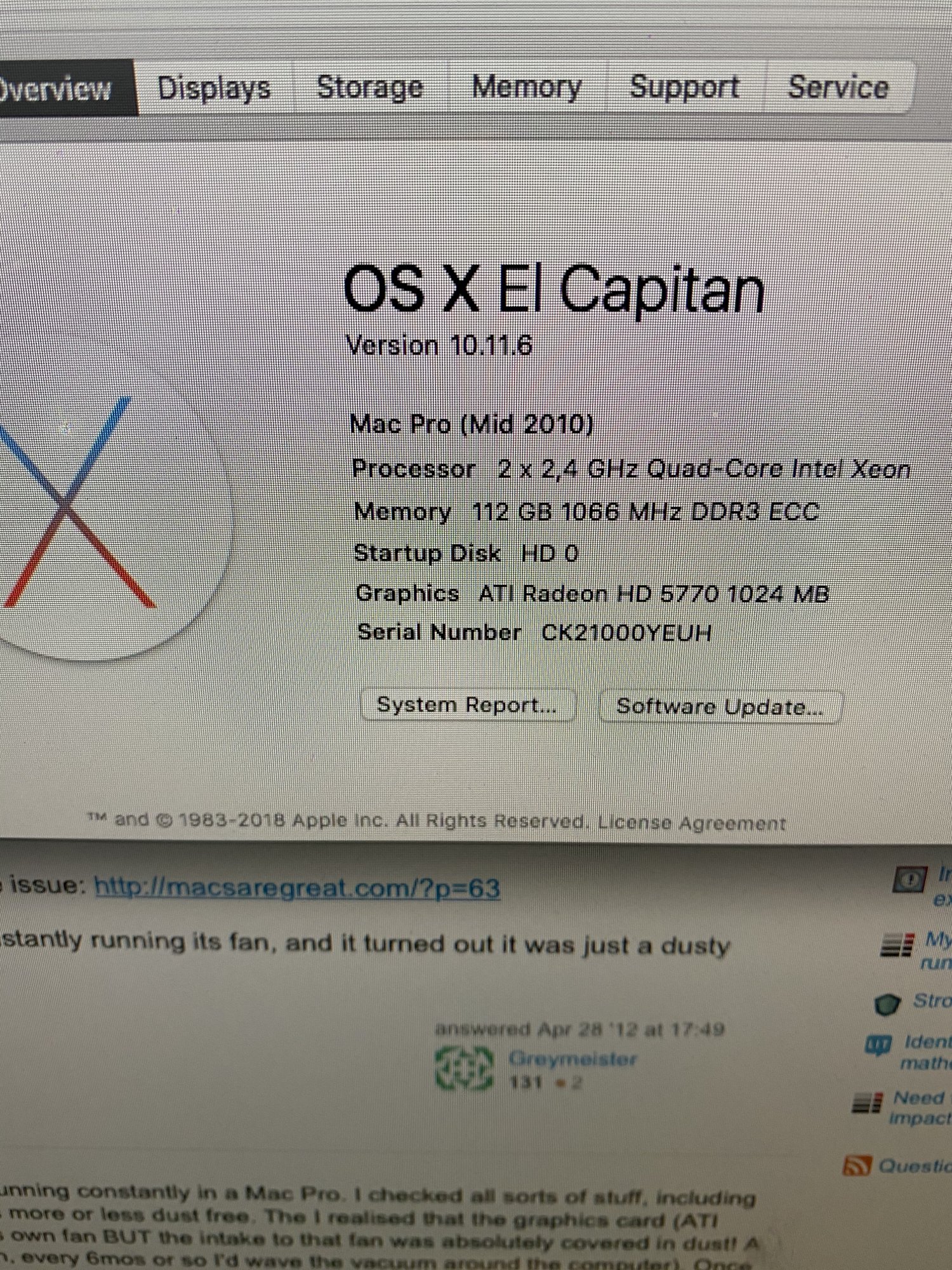

I am planning to upgrade my Mac Pro 5.1 which is now running Al Capitan to macOS Mojave so I can use Airdrop,... so do I need to update my Wifi and bluetooth card? I've checked and according to what I understood some models need to have a new airport card with WIFI AC And bluetooth 4. Could anyone please advise what things I need to buy to do this upgrade?

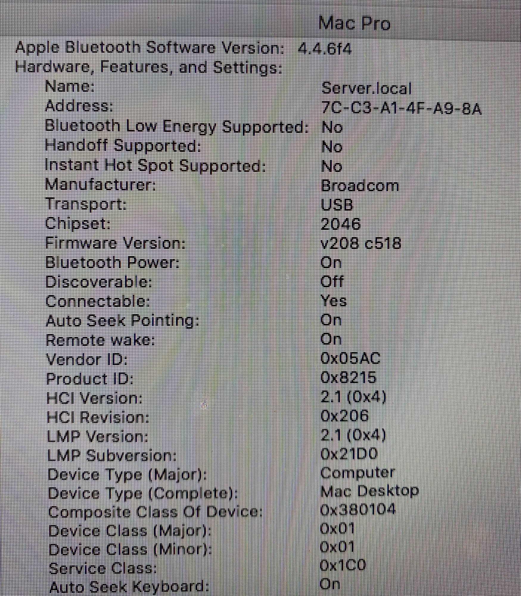

Below are the details of the current bluetooth and wifi so I appreciate your advice of what to do thank you

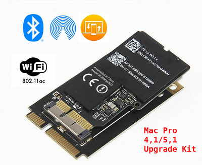

This kit is what I used, but any WiFi ab type and Bluetooth 4.0 for the Mac Pro 5,1 kit will work. Many kits like this available, this is what I have.
Note this kit has Bluetooth 4,2.
It’s a genuine Apple Card, 2017-18 iMac type.
works perfect for airdrop, Apple Watch unlock took some fiddling with to get working.
After install you will see Instant Hotspot, handoff, and low energy Bluetooth all supported, unlike the card you have now.

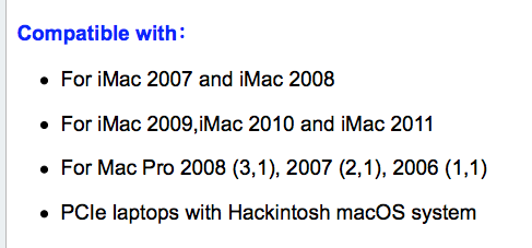

In the link you posted the Mac Pro 5.1 is not listed in the compatible devices. Any idea why?

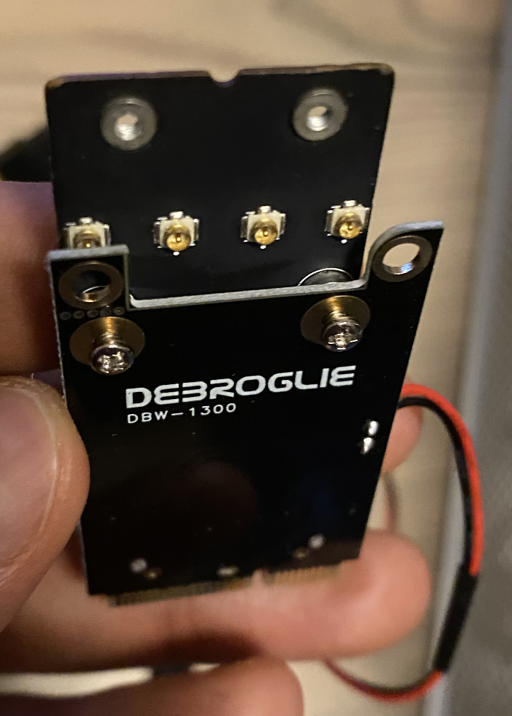

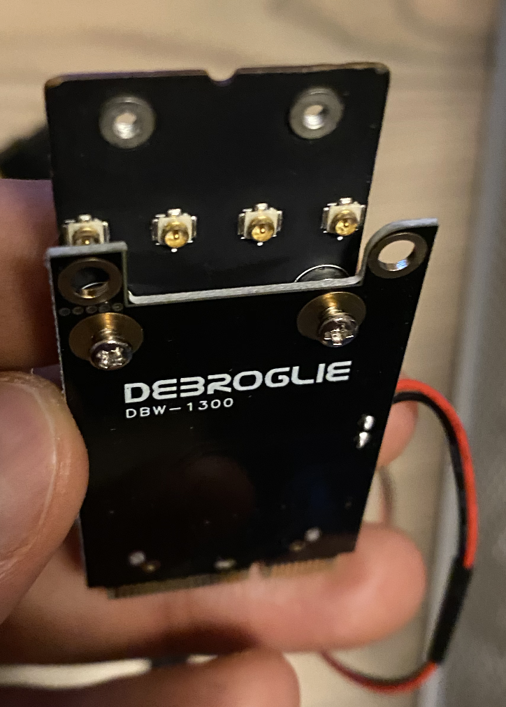

I received the wifi and bluetooth 4.2 things.

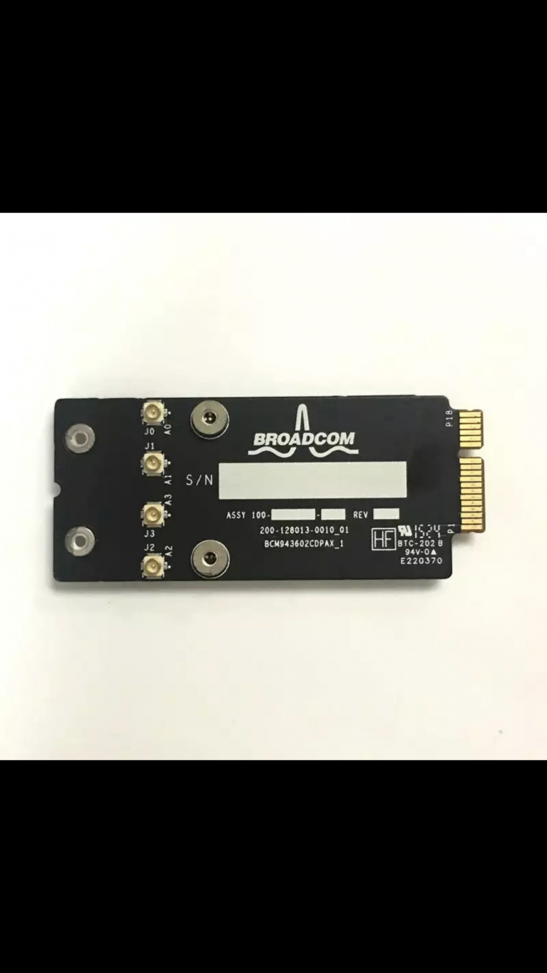

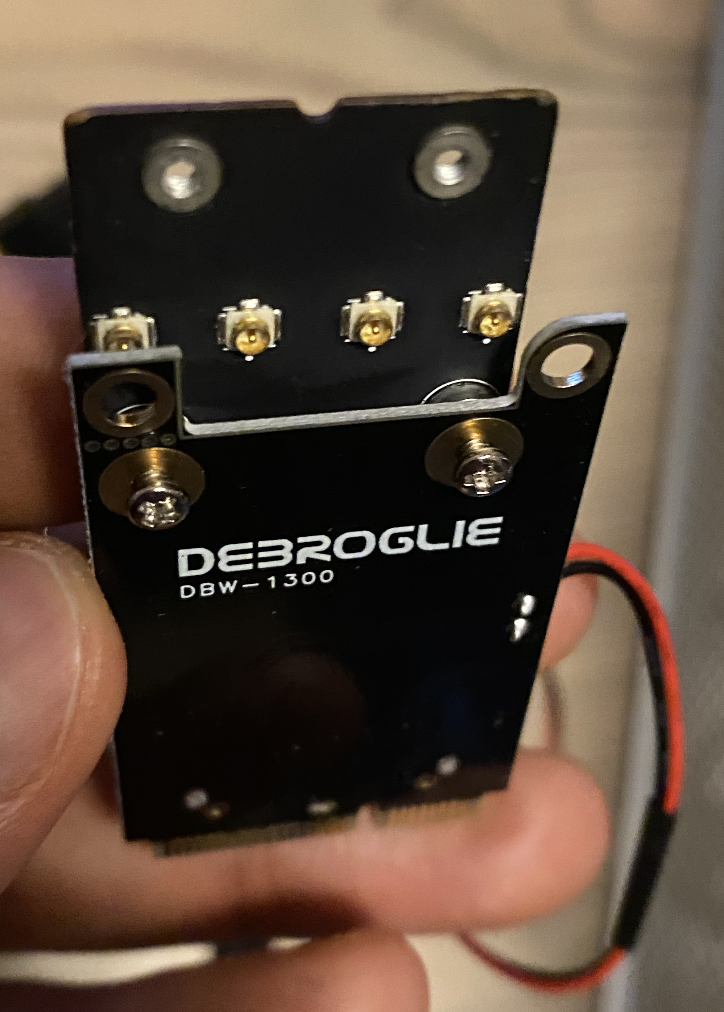

I have a question. On the wifi card I received there are no labels A0-3 or J0-3 as shown in the photo so I am not sure which cables connect to which ports. Any advice?
Just try them, if Bluetooth is weak, try another, it’s just antenna hook ups...
Does not matter, the other cables like the data cable going to the old Bluetooth header are important to get correct, antennas not so much, as long as it works...

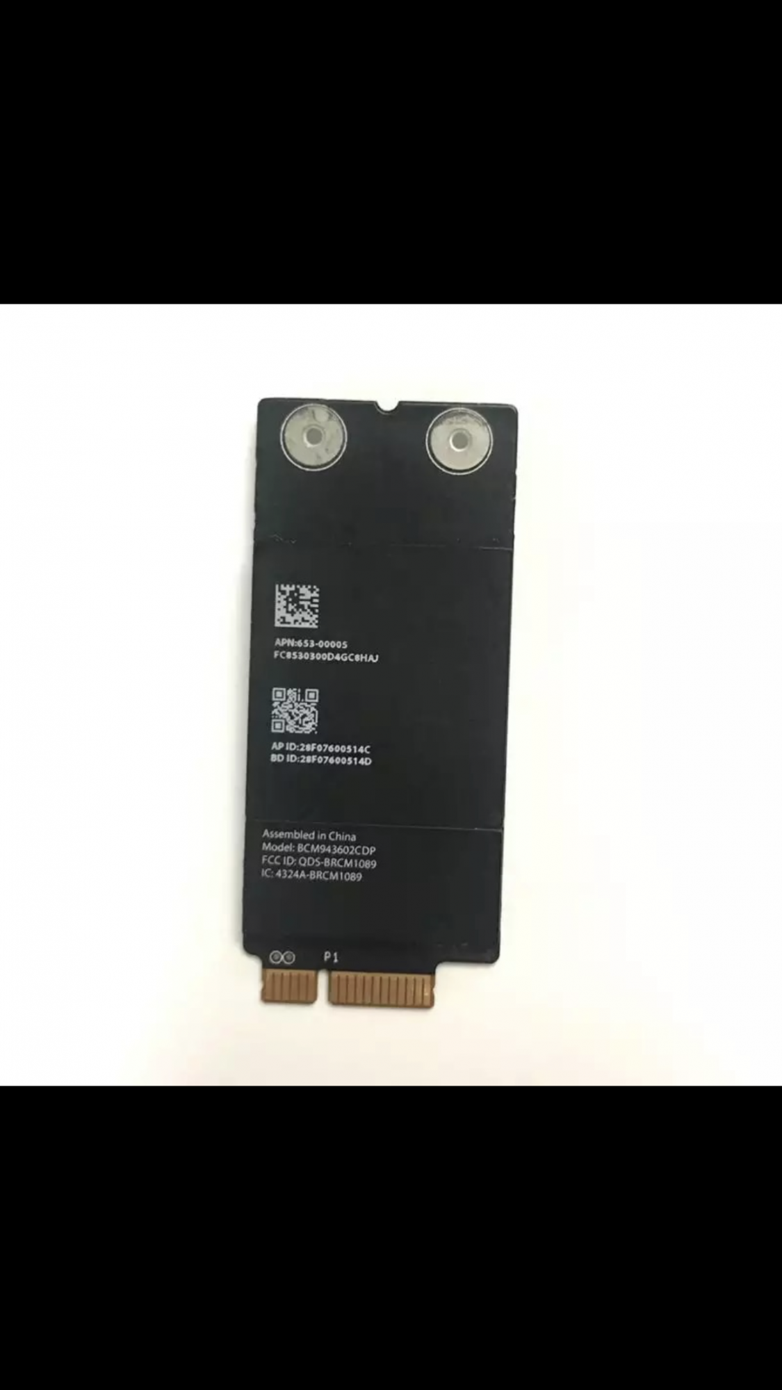

thank you. Or at least the right names of the parts. For example is this BCM943602CDP modul (in the picture) for BT 4.2?
Somewhere it says it is for 4.0 and somewhere for 4.2. Im confused.
What else i need? Some wires/cables and adapter?
