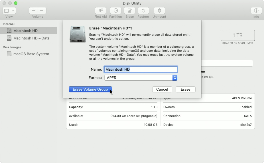

I hope that makes sense. Sort of looks like the image below (I merely Googled this one)...
In Disk Utility, go to menu item View>Show All Devices. I'm thinking you need to get rid of the separate partitions that are shown in your image.

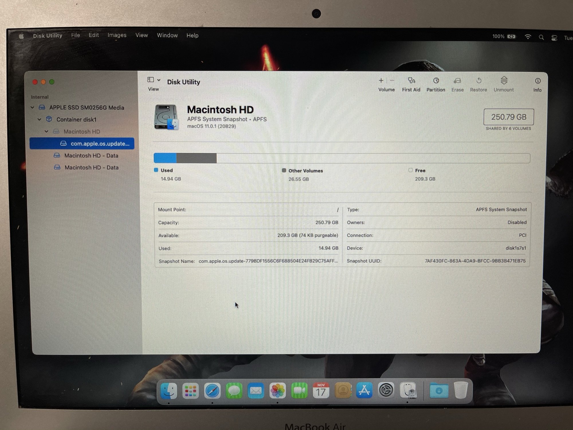

Sorry, somewhat confused now. Below is an actual image of my MBA drives. The previous image was merely one from online (Google)...
PS: I knew I could use shift+command+3 for taking a screen shot. But, it was another headache to get it to the forums (since I was already logged in, on my Windows computer)...
No worries about screen shot - can't really do that since to wipe the drive so you can reinstall you need to boot into Recovery mode. Which you haven't.

Started over, based on the detail in the link you sent (THANKS!).
The partition drive(s) were erased; used the volume group first, then also deleted the second partition that was labeled data (using the minus sign).
Once the above was done, it showed just ONE drive (versus the two, Macintosh HD & Macintosh HD - Data).
Big Sur is now being installed, again 😀 See you all in 44 minutes...
