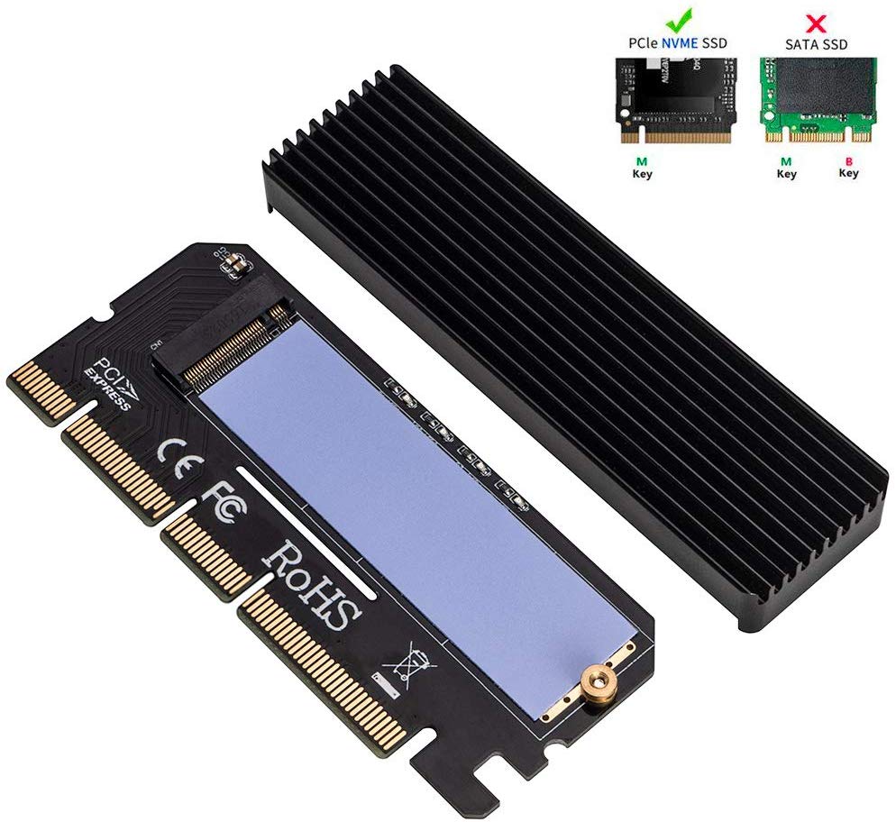

It's this adapter
it's a x4 adapter made to be installed with x4/x8/x16 slots. You can see that the data lines go only for the x4 slot.
All M.2 devices are x4 or less.

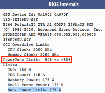

It's a really bad choice for a MP5,1. It's a 2.3 slots wide card and when running Furmark or something really stressful, this card can use up to 262,5W (175W x 1,5 PowerTune), with typical load use around 237W. So, it's a card that usually triggers the backplane overcurrent limit when in load.
Some people here got it working, you don't run Furmark all the time, but if you ask, a lot of people will tell you to don't use this card.

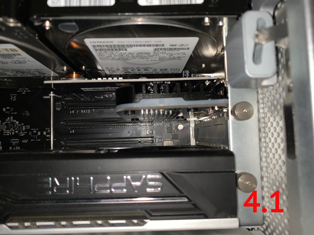

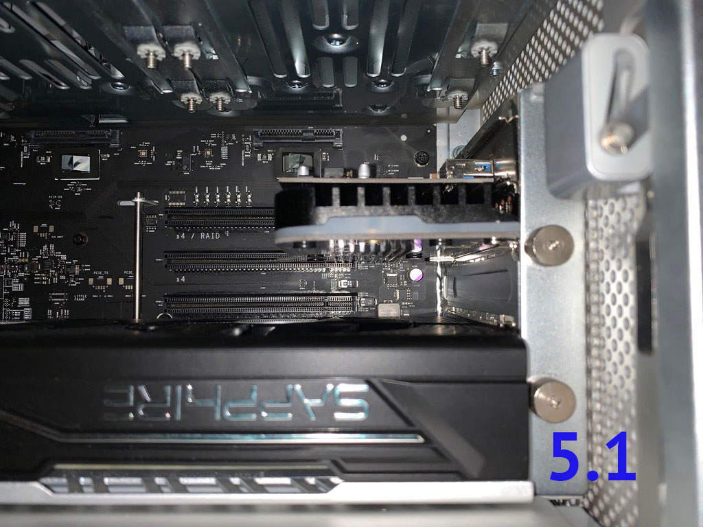

the sapphire pulse RX580 8GB works well in a real 5,1 and you can use
slot2 if you put a little spacer between the two cards.
this does not work well in a 4,1 !
see the difference of booth enclosures:
but I don't know where the difference comes from
it's the same card i testet
