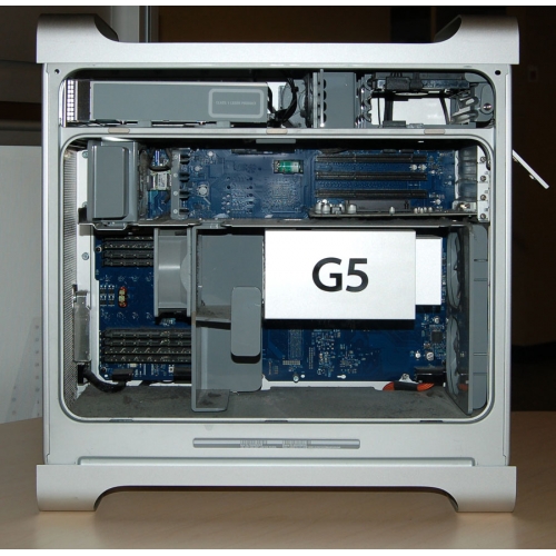

I have a single 1.8 and it has 8 slots...

Looks like you need DDR-2 PC2-4200, and should have 8 slots.
I didn't believe it but this proves that they did...
