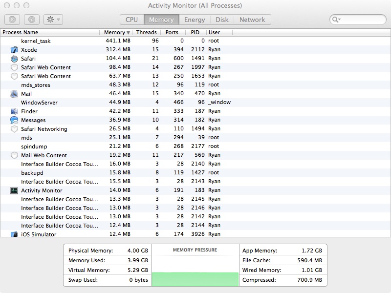

Start Activity Monitor and go to the memory tab then move the app over to the side and leave it open. Now do some Xcode work and see if you can replicate the beach ball. When that happens look at the memory pressure graph at the bottom. If that is still showing all green, you do not need more memory.
I was able to successfully reproduce the beach ball (it happens every time without fail) but the memory pressure didn't change at all (see screenshot).
So apparently this means my RAM is fine, and I should upgrade to an SSD to fix this issue? Thanks

RAM is nice, but if you're dealing with big projects and you're always saving/auto-saving/compiling stuff, a SSD is the #1 upgrade.
