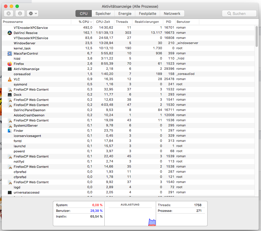

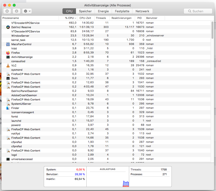

Interesting Topic. I also own a MacPro 5.1, but upgraded with two X5675 6-Core 3.06 Ghz and 48 GB of ram. But still with the same GTX680 as TS. Yesterday i did my first Davinci Resolve 16 Project and I noticed while coding the movie into H.264 the CPU only runs at less as 30%, so roughly at 4 cores instead of 12. Last year i did a Project using ShotCut, this software uses all Cores while coding the movie.
So is the bottleneck the GPU? Would a Vega 56 or Vega 64 give a huge boost? But, if I installed the Vega, do I have to activate the hardware acceleration? Do I have to upgrade to Mojave? I just installed High Sierra to run Davinci Resolve 16.
I'll will check if hardware acceleration is enabled on the GTX680.
Davinci Resolve loves GPU power and supports even dual GPUs. If you want to go the Mojave route, you need to go the AMD route. Mojave will not accept Nvidia GPU's, (a few rare & bad exceptions). There are no more Nvidia Web drivers and no Apple default drivers anymore for Mojave. A move to a powerful AMD GPU would provide a big boost for your workstation, especially with Davinci. The GPU is actually more important theses days. (That's why Apple gimped the hardware acceleration intentionally to give you more motivation to buy a new Apple computer)

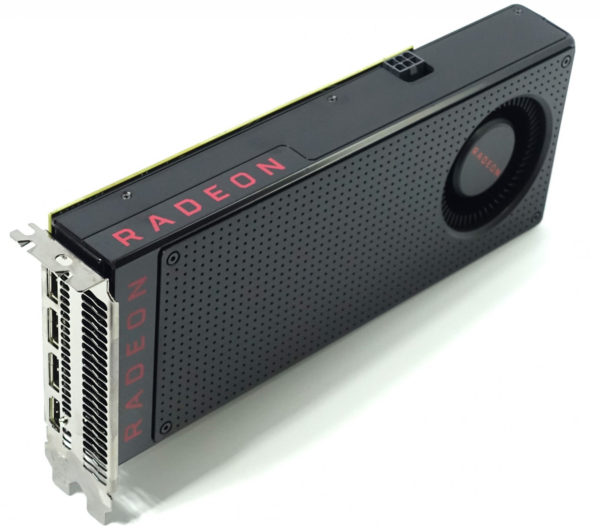

The blower type RX 480 8GB graphics card looks like this . It has the right shape , cooling ability for a workstation and requires only a single standard to mini 6 pin PCIe power booster cable . And it is easy to install two of these in your Mac , but they do take up a lot of room !

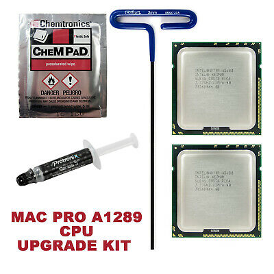

i did the X5690 upgrade 3-4 years ago, you just need the cpus and a tube of thermal paste.
just watch some videos on how to apply arctic silver.

What card are working best? The Link on Post #4 mentioned the Vega 56 and 64 along with the RX560 and RX580, although the last 2 gave some problems. Are Cards like the RX480 supported? The RX480 also have H264 hardware acceleration.
Well Catalina still runs on the GTX 765M on my iMac 2011. But indeed the Nvidia-Route is dead.
For I am still on HS, still have some older Software like Photoshop, still wonder it runs on HS. I first have to test the support on Mojave.
I used to have two different versions of the Vega 64 in my 5.1 at times after I sold my trusted 980TI card two full years ago.

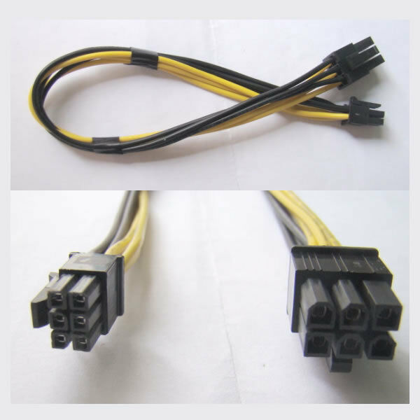

The Vega performed ok for my needs, however, I was not satisfied with the cooling duct fan. The card heated up tremendously after a while, also the nicer Limited Edition with the Alu shroud swap didn't make a difference. The cooling was the main reason why I grabbed a Vega VII. Finally a great card with normal cooling. The Vega VII is already EOL, so you could get one for a great used price on eBay, but I would also recommend the new 5700XT card, because you will not need the pixels mod for that card. But it would require the newest MacOS software for the included drivers on the 5700.
Since not everyone wants to spend bigger money on old tech, the overall best budget/performance option would be the Red Dragon Vega 56 with its custom cooling fans. This way you can save money, but have a better cooling system. If you go this route, make sure you use the EVGA PowerLink for the best-balanced connection.
Apple itself recommends the Radeon 580 Pulse, however, this card was too weak for my needs.

I'd recommend a Westmere 6-core CPU e.g. X5675/5680/5690 , more RAM (1333mHz) and a NVMe drive .
You'll get the fastest RAM when installed 3 modules ( and 6 for DUAL CPU), so e.g. 3X16GB.
NVMe drives are about the same price as an SSD but much faster, depending on your budget you could buy a simple PCIe X4 adapter card e.g. KRYO EVO for ~ €30,-
