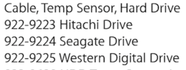

I believe the 2010 iMacs had a 2 TB option, you could go and buy a 2TB replacement drive for it. This will probably cost more however.
I know alot of Seagate and Hitachi drives seem to work, so if you have a hitachi or seagate drive currently, get a similar model but obviously 2TB.
I know the seagate DM2001 (iirc) should work fine.
otherwise you can get the cable adapter for pretty cheap on ebay, ifixit or other places.
i attached an image with part numbers for the cable.
