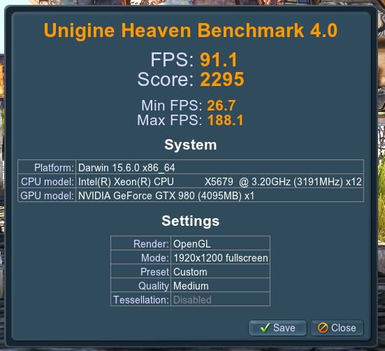

That's a pretty good score.
I have a 980Ti and it's just above that, not massively. Almost disappointing! Or the CPU is the bottleneck?
His benchmarks runs at a custom resolution / setting with tessellation disabled, you have the exact same setting?
I disabled it too. But for some reason it scales to a different resolution. Probably because my monitors are 16:9 aspect ratio and not 16:10.
