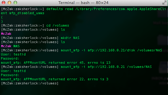

Hi Nathan,
My understanding of the process was that you had to attempt a connection, so that the OS would create that disabled uams parameter list....and then you write to the list to remove those exclusions.
Anyway, it might be quicker to include some screenshots.
Mavericks Install: Connection attempt after populating the uams list
Mavericks Install: Connection attempt after running commands to remove disabled uams.

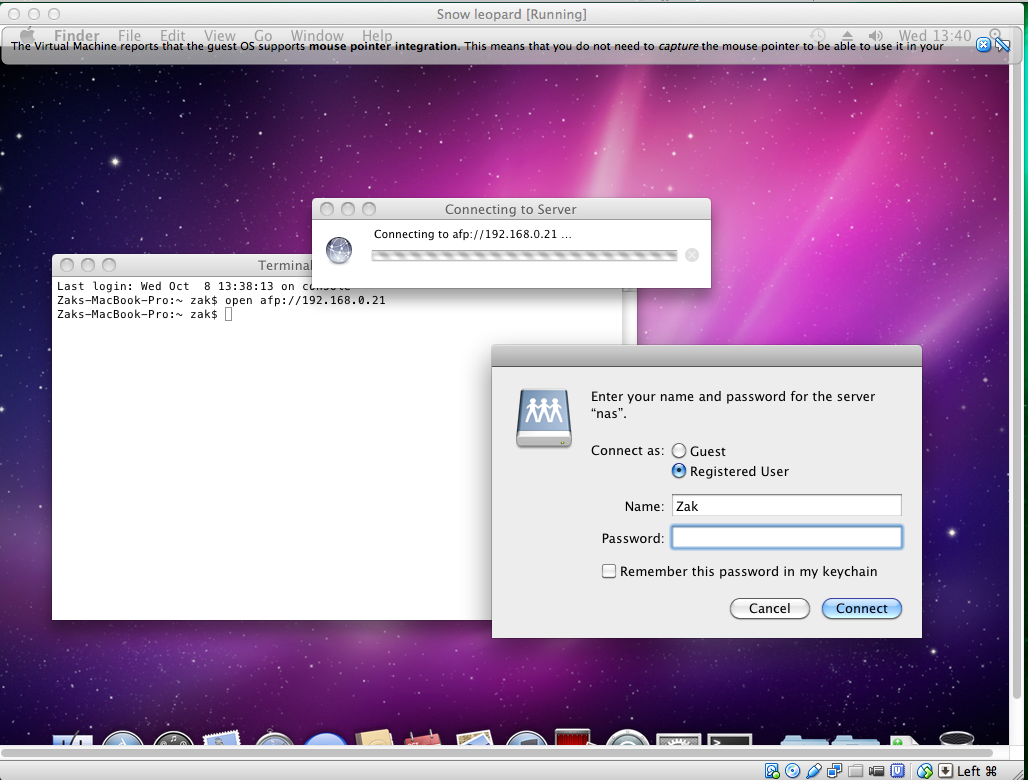

Mavericks Install: Connection using a snow leopard virtual machine in virtualbox.
This would be great, if only virtualbox had support for USB ports in an OSX VM. It works and i can see the files, but without the ability to migrate them onto another USB drive Im a bit stuffed.

ps. using "open afp://.....etc" on mavericks just gets the dialogue that it cant connect to this version etc.
pps.the nas supports multiple accounts anonymous/guest and many others including testid. I've tried numerous permutations but havent put *all* the screenshots up since i was just trying to eliminate any login conflict on the nas itself. all of the accounts work when used with the SL VM.
