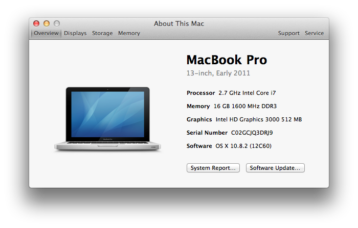

The F3-1600C10D-16GSQ kit works on a MacBookPro8,1 Early 2011 13" Core i7 (I7-2620M)
