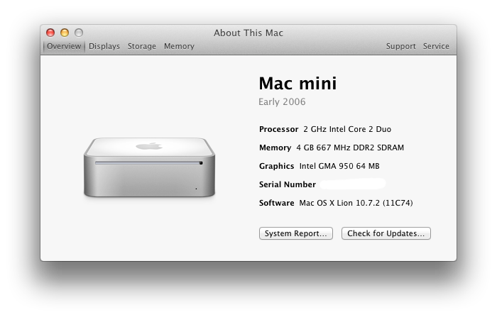

I've done it today and can confirm that 3GB of RAM works. Unfortunately, board ID is not changed this way so Lion install USB still does not run without modification. Read #46 by MacEFIRom and #67 by Sebinouse.
http://forum.netkas.org/index.php/topic,874.0.html
