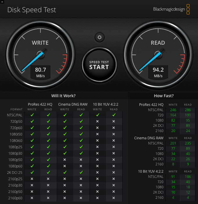

If you get a chance, download Blackmagic disk test to get some actual read write speeds for us. It is free in the App Store.
Did you rejoin the new hard drive with the existing SSD, so that the two devices still function as a fusion drive?
I didn't. It sounds like that's my problem. Thanks for the link. Is there any concern regarding data-integrity with my rejoining the drives now that I've been operating with just the spinning HDD for awhile? I see the following in my Disk Utility (Vertex is the name of the new 4tb drive).

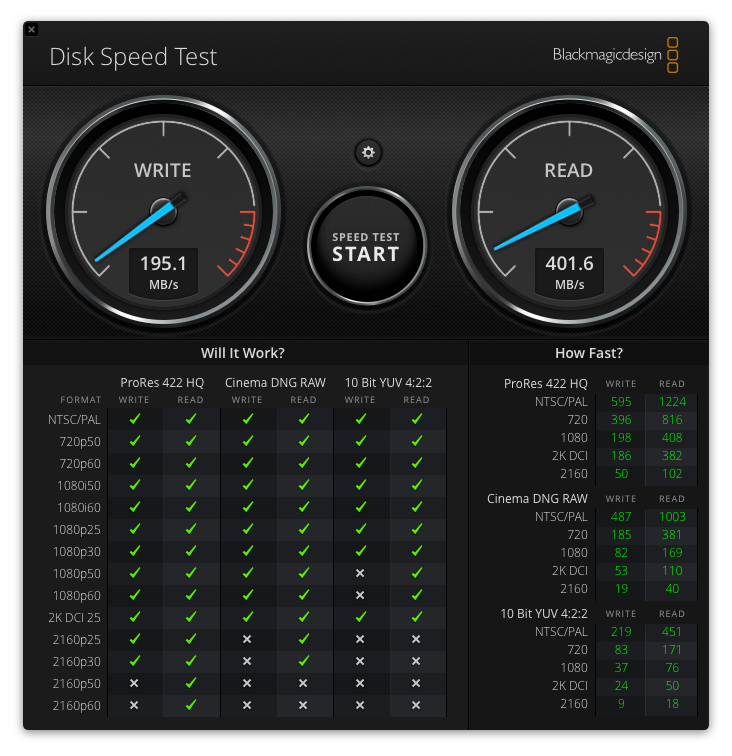

Finally got around to resolving this. I tried to reset the drive to fusion mode, and it alerted me to S.M.A.R.T errors while trying to do the OS re-install. Replaced the drive a second time, and now I'm back to suitable performance.
