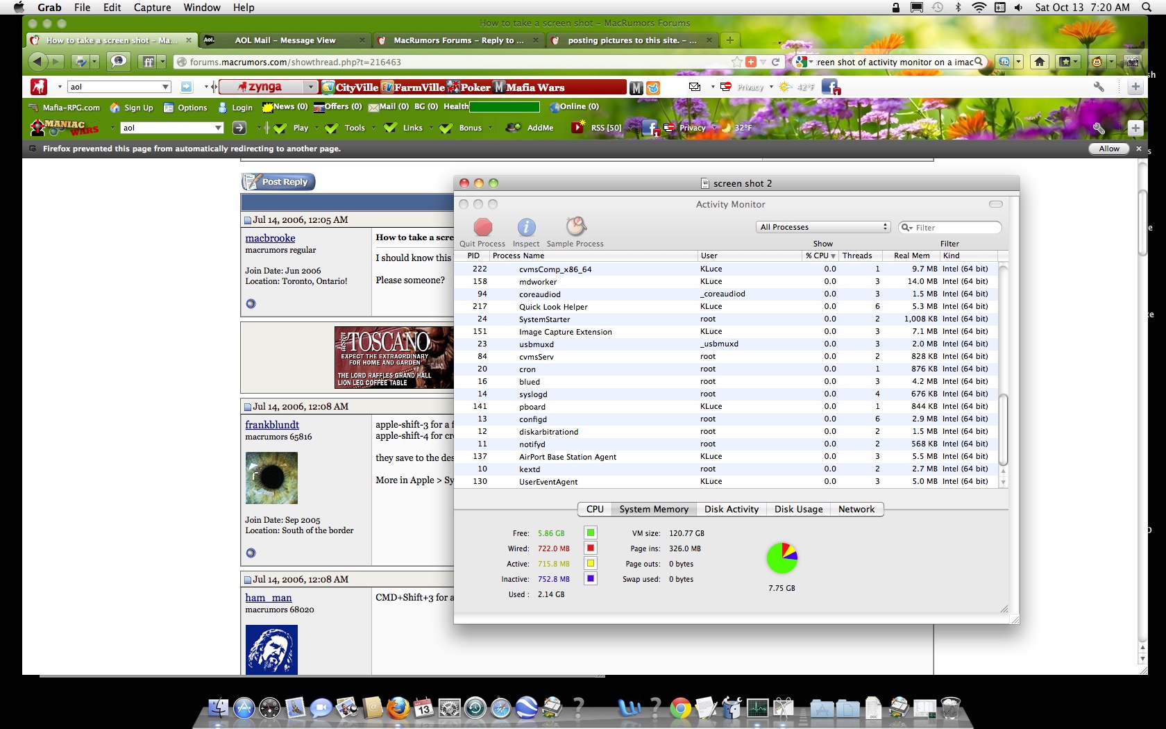

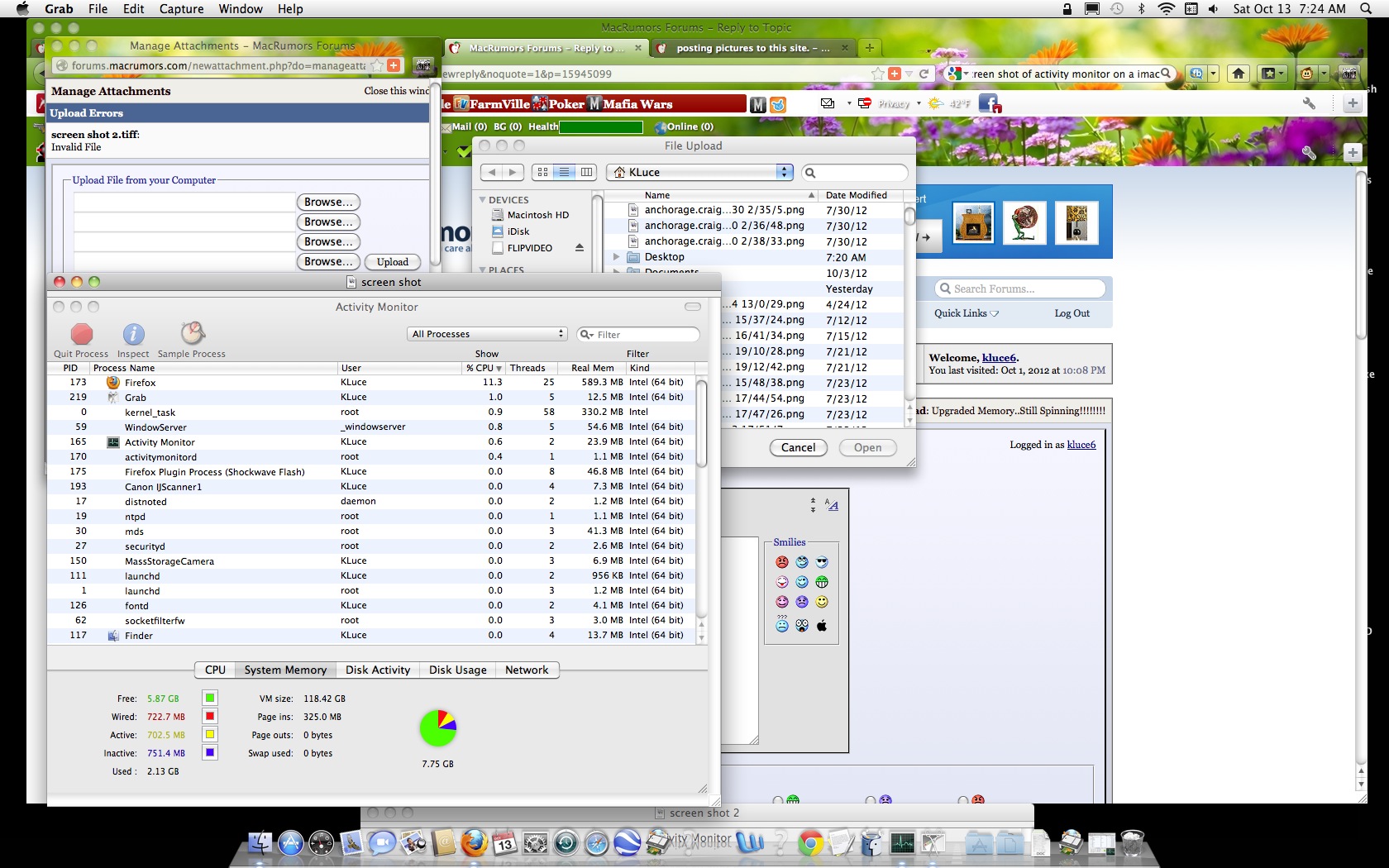

Thank you for your reply, I appreciate your help. I'm posting the screen shots you requested. Kluce6 🙂

You aren't having any problems with RAM, as you have plenty of free RAM available. There is nothing in your screen shots that would indicate high demands on system resources or a cause for beachballing. Were you getting beachballs at the time of the screen shots?
