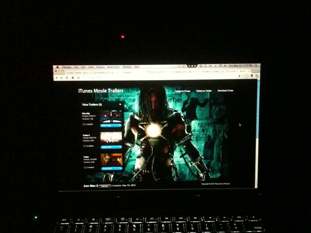

Added a couple pictures. The first is the old panel, second is the new panel. Not a perfect comparison, the first picture isn't focused as well as the second. Pictures were shot with a 3GS. The first picture has a faint red light on the keyboard. And the second picture, the keyboard light is turned up a little. In both pictures the glass is removed. That is why you can see the light leak at the bottom from both screens.
