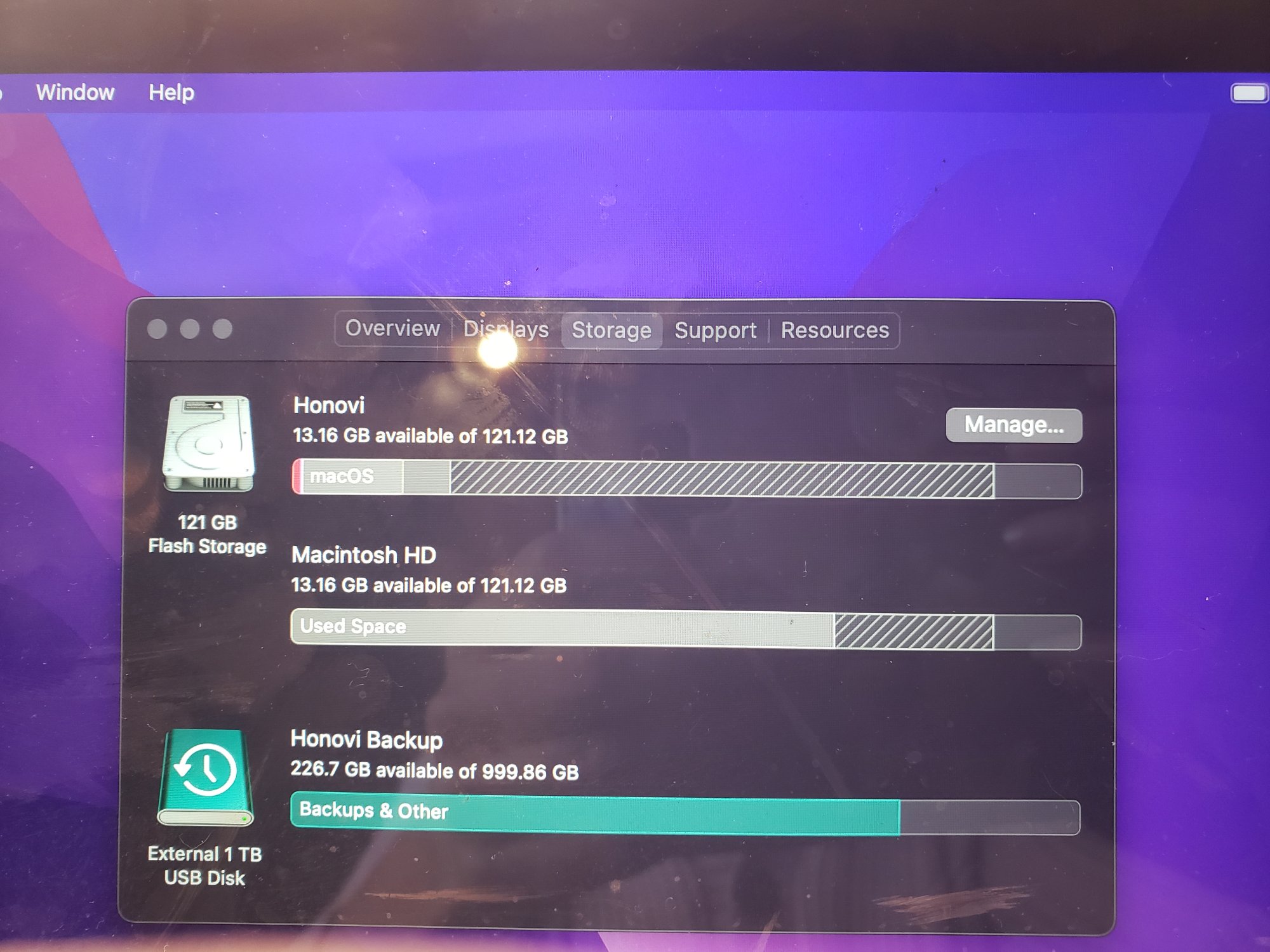

I recently upgraded my MacBook air to Monterey from Catalina but I have two disks showing on my desktop.

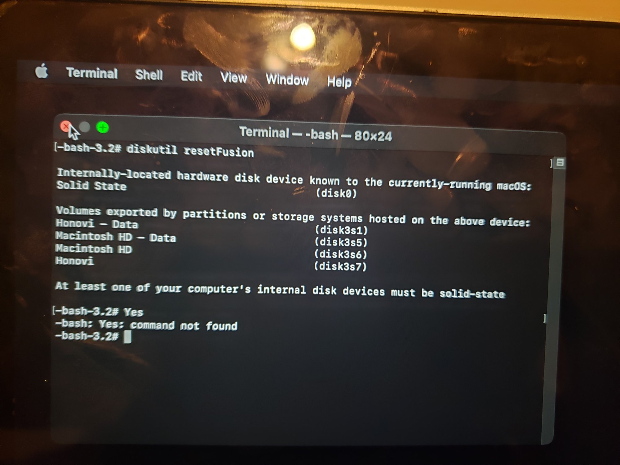

I tried to make them one disk by following some online instructions I found which I typed into the terminal... I received the following message [see screenshot] what does it mean that one of the computer disk devices must be solid state? How do I make it one Hard drive from here?
I'm kind of regretting upgrading because I didn't realise all my data would be wiped [I made a back up to my external hard drive so I have all the data saved] but I noticed I now have less space on my HD before I had 30+GB and now its showing only 13.16GB remains on my upgraded system...?
If someone could please advise I would be so grateful. Is there a way for me to revert back to my older system with all the files intact? [As I said I made a back up its on my hard drive]

You followed the wrong instructions.
What you've found is an instruction to split a Fusion Drive.
What you see on the Desktop is "Honovi" and "Macintosh HD", right?

I followed the instructions described here from Apple support to fix a split Fusion not create one so im not sure why you're saying that - these instructions aren't incorrect from what I can tell: https://support.apple.com/en-us/HT207584
I need help to make it one drive.
Yes on the desktop it says Honovi and Macintosh HD.

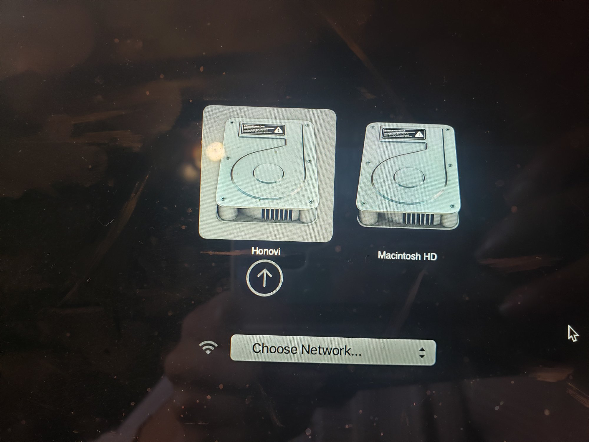

I held option on start up and received this. See image. What do I do from here? Which drive do I select?

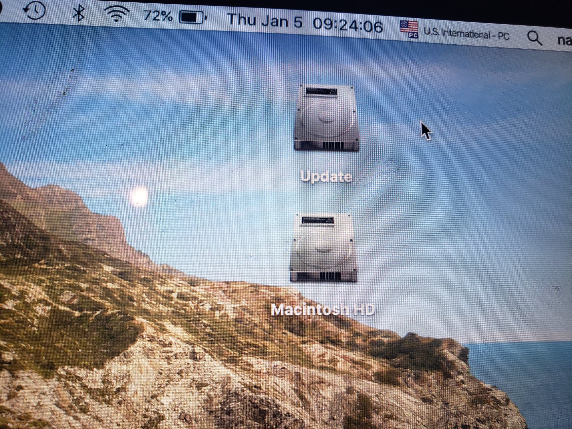

Selected the HD drive and its taken me back to the old system which was actually Catalina but there are still two drives on the desktop. Not entirely sure how to resolve this issue of deleting the one called update.
Update is a hidden volume in Monterey, the filesystem changed from HFS to APFS when you did the upgrade. Monterey now uses a fully read-only volume for the OS, which is separate from the data volume. It's all in the background, when you are using Monterey, it all looks like one drive. If you are booted in Catalina, that is why you see both volumes.
Either - one will lead you to the new system (Honovi), the other - to your old High Sierra. Catalina

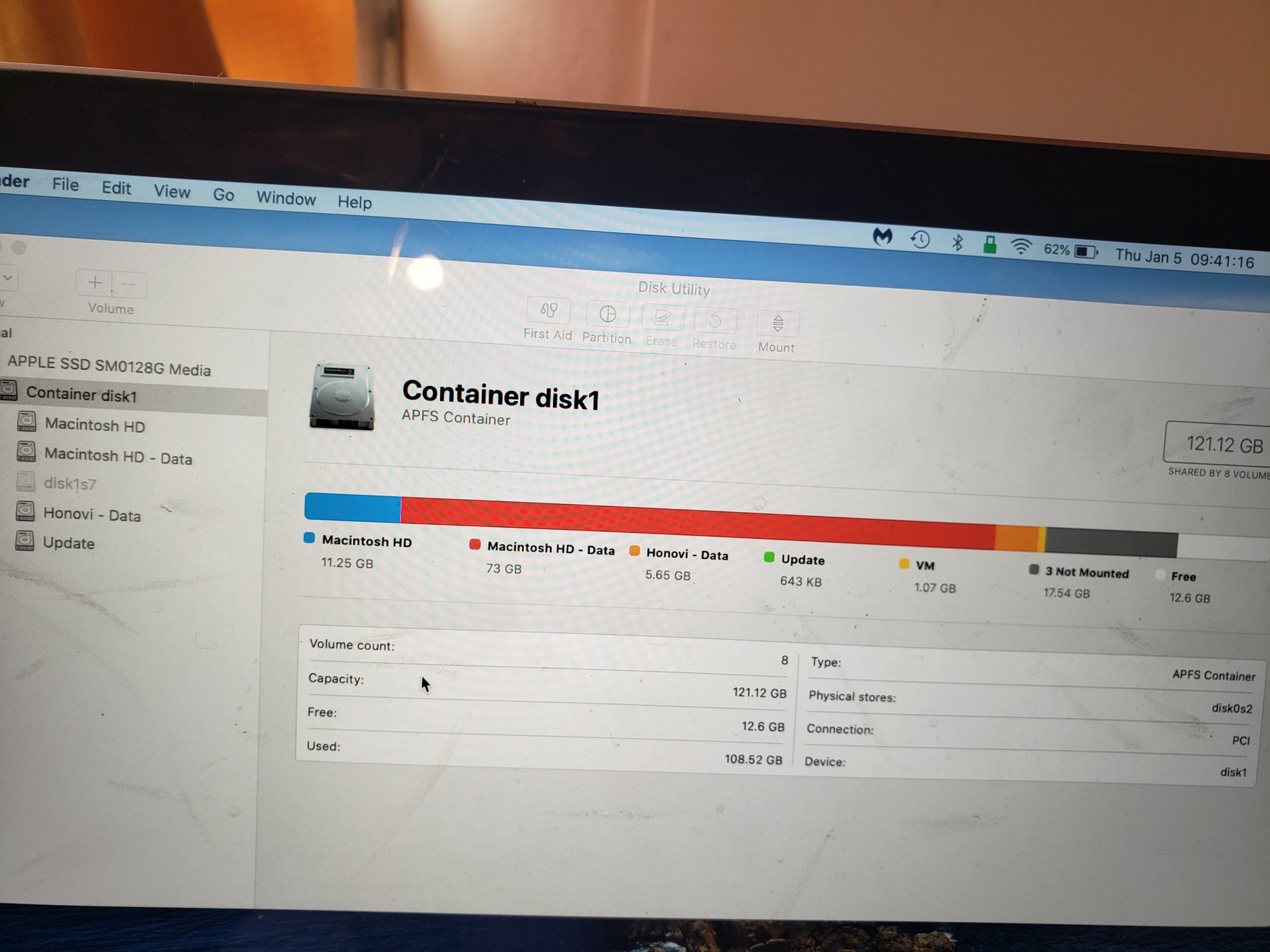

Hi JM thanks for your response it actually looks like I have multiple HD's 😱
I'm not a mac expert so I'm not sure how to resolve this... how do I know which disks to delete? I think I will just stay with Catalina for now until I get my mac to someone who knows how to do the installs. It took like 20 hours and didn't even work correctly 😪

Wow, not sure how you got that many volumes out of an upgrade.
If you have backups of your data, you might consider just an erase and reinstall like hwojtek mentioned. It's not too difficult, boot to recovery (hold ⌘ & R when you power it on), erase the entire drive in the disk utility (pressing ⌘ + 2 will show everything), then run the installer. Most Macs will do a Monterey install in less than an hour. You can run a Time Machine restore after it's done.

Which OS do you want to keep? Catalina or Monterey? Have you been able to determine what OS is on Macintosh HD, and what OS is on Honovi?
From the screenshot, I see you have one partition (container disk1) with multiple volumes (Macintosh HD, Macintosh HD - data, etc.).
Macintosh HD & Macintosh HD-Data should be the Monterey OS. It looks like Honovi is your Catalina.

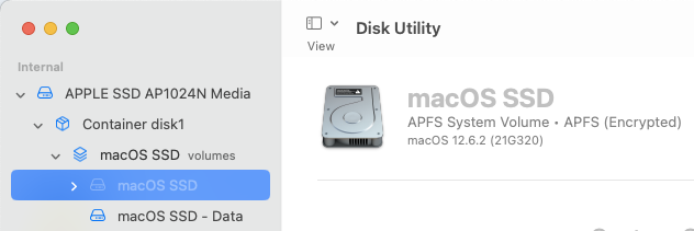

I've enclosed a snapshot of what Monterey volumes look like when booted in Monterey. Notice even though the Disk Utility reports my macOS SSD as having two volumes, it looks like one volume in the OS.

Macintosh HD is Catalina and Honovi is Monterey. Do I just click on erase to remove the volumes? What is this volume HD called update? 🤔
Also it says I have 2 Macintosh HD's.
One is called Macintosh HD the other Macintosh HD - Data - how do I know which to keep and which to delete? Thanks for your help 👍

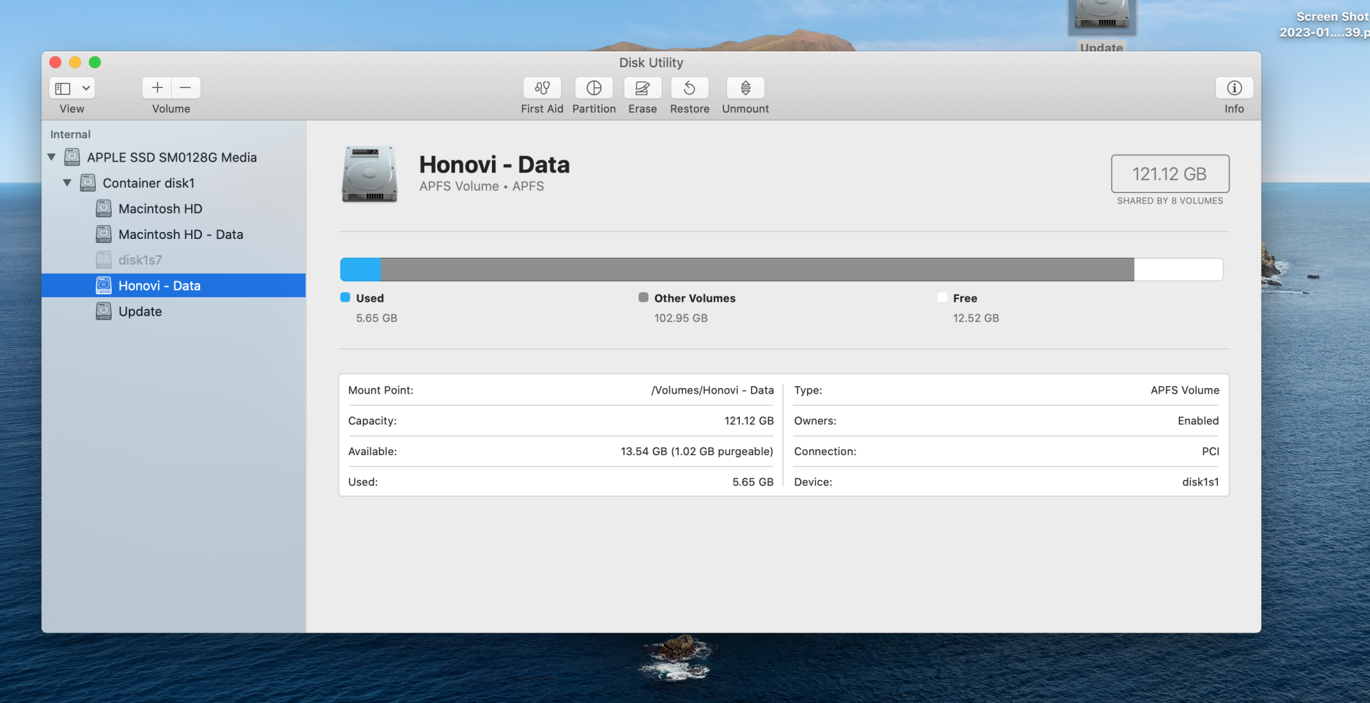

This is what it shows after I ran diskutil on my mac... this is so confusing 😪 I noticed when I go to disk utility it only gives me the option to delete update and Honovi - Data.
I can't delete the other 2 which are called Macintosh HD and Macintosh HD - Data [the latter appears to be the one I want to keep]
If Honovi is Monterey, that's the one you want to delete. Select it in Disk Utility and then click the minus volume button. Make double sure that you have backups of your data before deleting any volumes.

Do I do the same for the HD called updated?
Sorry yes just saw it. Its asking delete volume group or delete - which do I select?
The rest of the volumes should be part of Catalina, you shouldn't need to do anything else. I don't think that Disk Utility will let you delete volumes of the current running OS (Catalina in this case).
