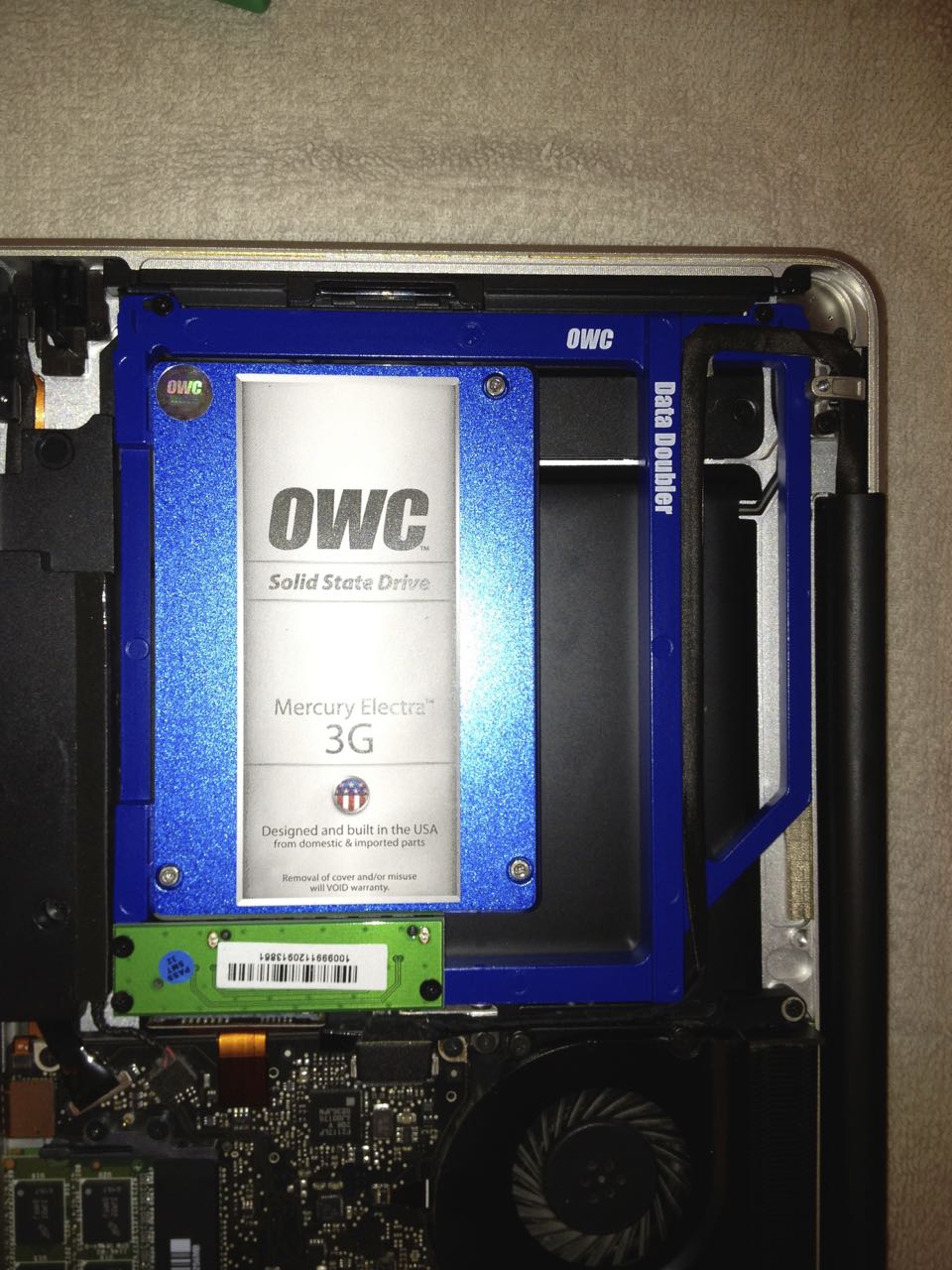

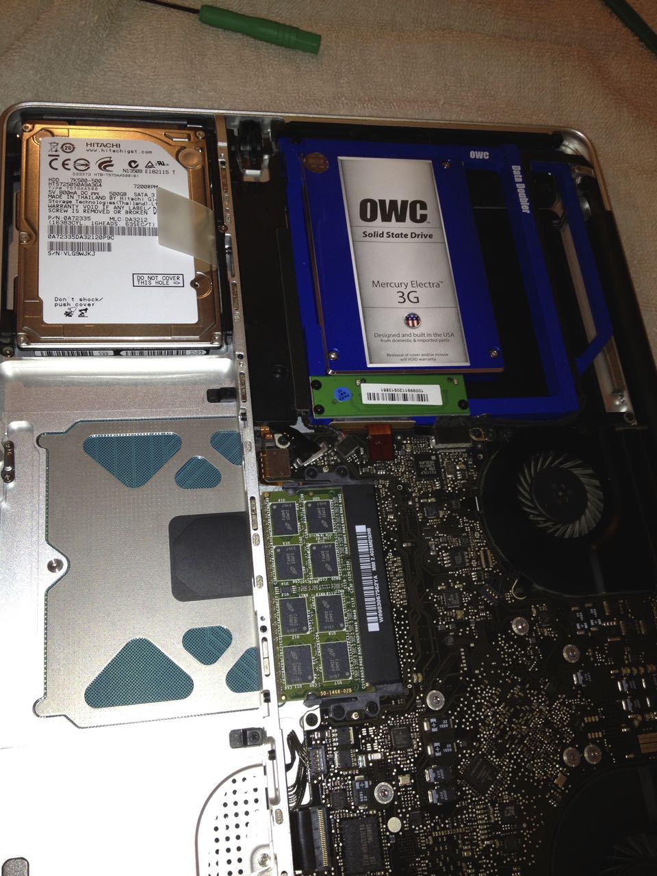

I didn't have to remove the logic board to install my optibay from OWC in my 2008 15" MBP. I've got pictures around here somewhere ... let me see if I can dig them up.
Photos below. You can see the logic board was not removed when I installed mine.

Wow, you took quite a detour to install an opti-bay, you definitely don't need to take the logicboard out to do it...
