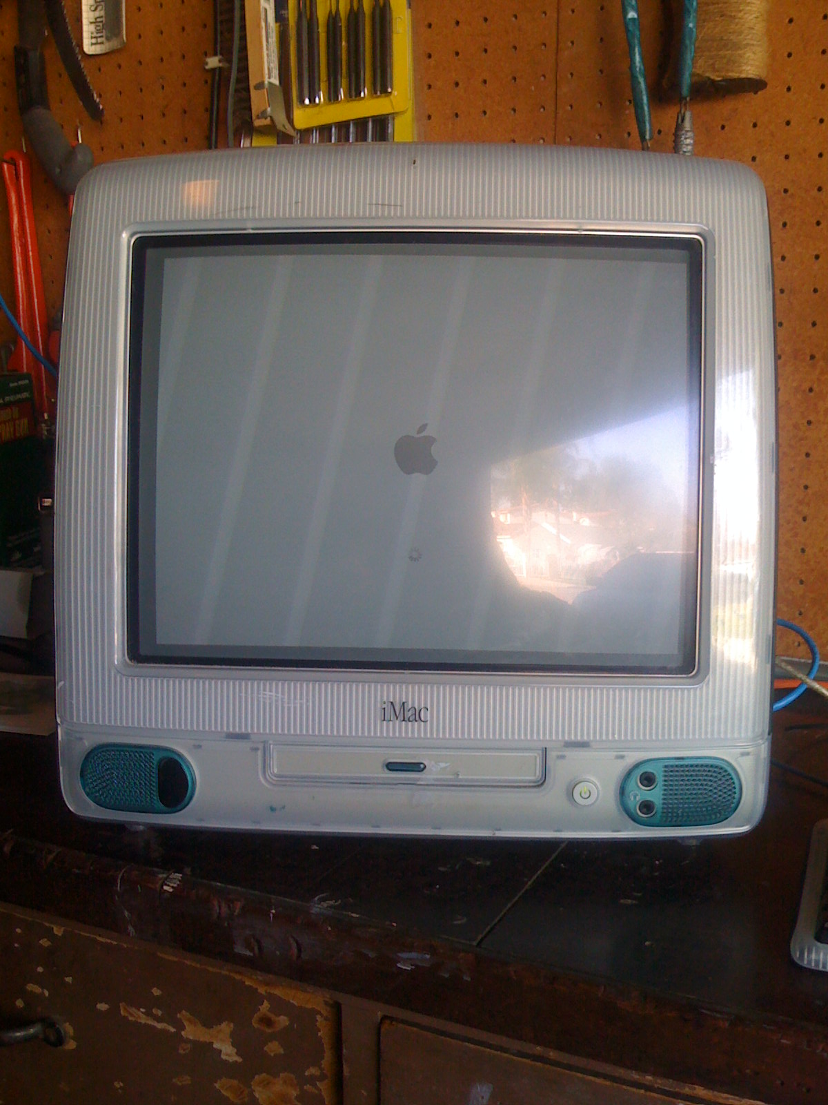

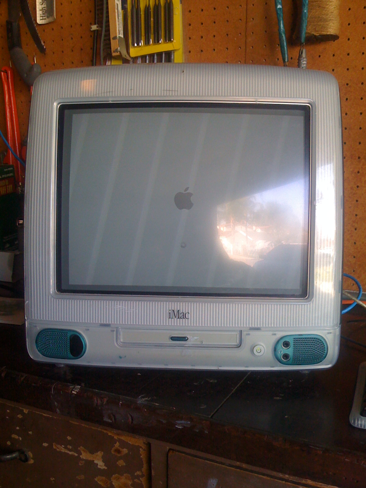

I have the machine at home now with a few issues. He did not get OS X installed but he did get 9.2.2 and firmware 1.2 on it. He also partitioned the drive to the full 128 GB and that might be the root of the problem I'm having now. I am trying to boot on the 10.2 CD he lent me so I can repartition the drive and install it. It's just sitting at the apple screen and not going any further. I suspect it's either because the drive is already partitioned too large or something else that I know nothing about is happening.

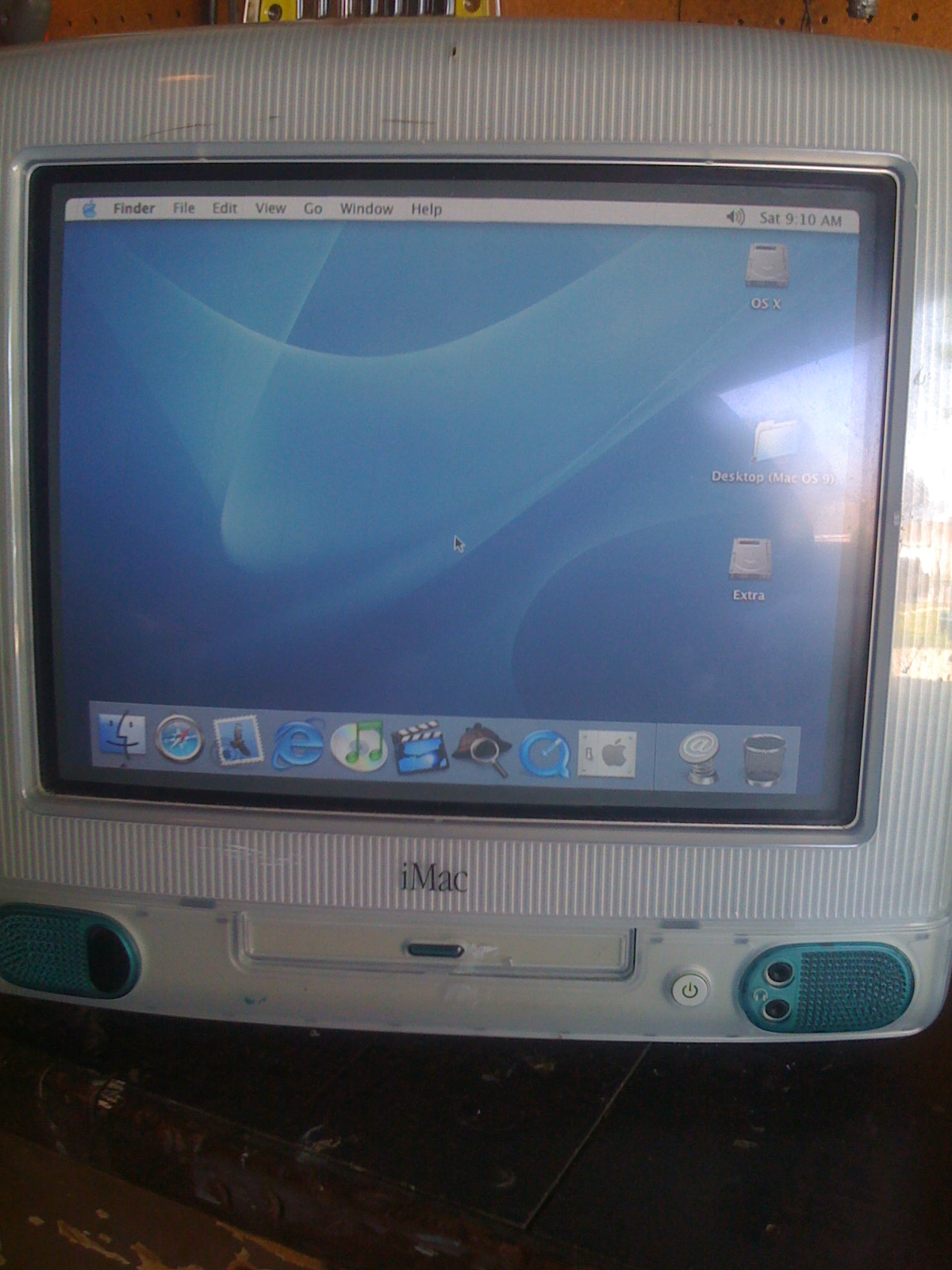

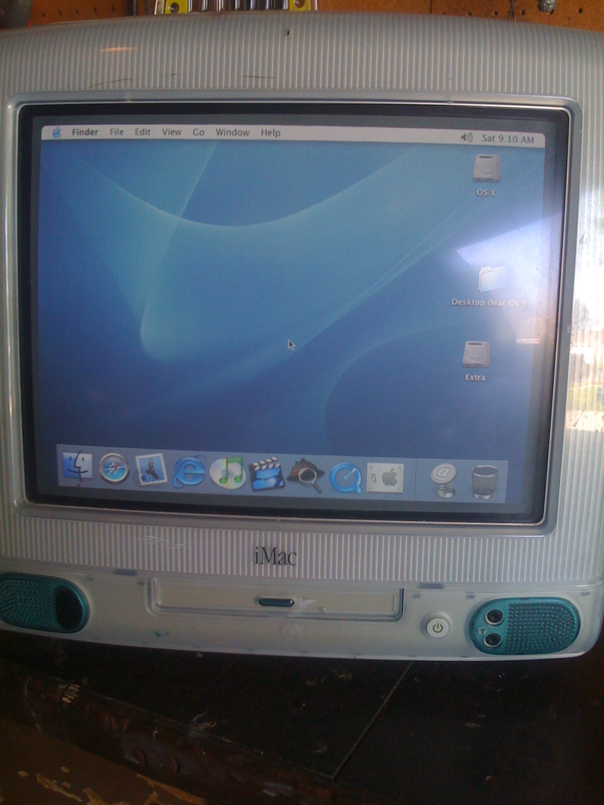

Success! I now have 10.3.9 and I'm updating Safari and a few other things. Now I have another question.

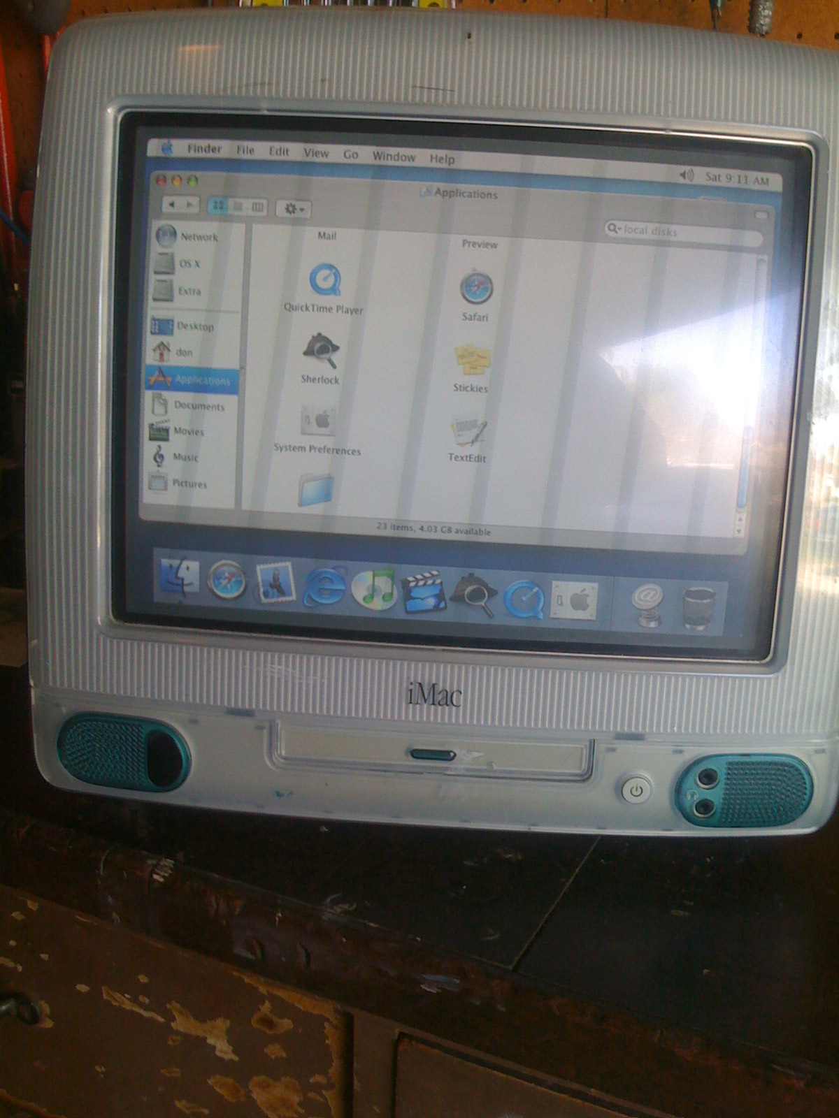

I put in a 160 GB drive of which the machine can see 128 of which 8 is dedicated to the OS X install. This means I've got a partition that's about 120 GB sitting there. When I install software does it default to the OS X(small) partition or will it ask me where to put it? I know with a PC it asks but since I'm not terribly familiar with the Mac I want to make sure I don't fill the 8 GB partition if it's easy to just point to the big one.
Before that though I want to thank everyone who offered suggestions, help, and just plain moral support. You've helped a Mac newbie take a $5 piece of almost useless hardware and turn it in to something that I can actually use quite a lot. I'm sure it helped that I'm already a PC geek but there's a lot to learn and I'm just getting started.
Here's a couple of shots of it booting up. 😀

Yay! I'm posting this with the Mac using Firefox 2. I also moved it inside the house so I can actually use it without having to go out to the garage.

It depends on the Application. Most Mac applications are just dragged and dropped from a .dmg (disk image) to wherever you want to put it. Others like iTunes or major software from Apple like iPhoto etc. use the Mac OS X installer and usually lets you pick where you want to install. I hope I was clear enough...🙂
