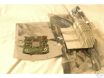

If its a G4 ZIF. Does it have like 100 pins underneath it. If so, you just unhook the little metal tab holding in the G3 and then take it off. Then just replace. If you put up a picture I could tell.
This is what the CPU look like
You'd also have to apply the firmware patch FIRST (runs only in OS 9) to remove the code that apple put in to keep this upgrade from working. Look at OWC's tech center for patcher.....

a ZIF cpu will work (may need that patch if it's a G4)
no "may" to it, if you wanna G4 in a B&W, ya GOTTA do da patch, in OS 9.xx only. Been there, done that, many many times 😛
ZIF = ZERO INSERTION FORCE = drop in/lock in socket. That is the key to look for when shopping for a B&W upgrade.......
