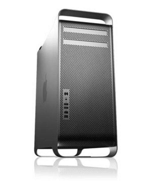

Hi there,
I was wondering if anyone knows if my old mac pro (early 2008) has any possibilities of being upgraded, and if so what should i upgrade? If someone has the time i would love getting some links for what i could buy that works with this model.
I am using my mac mostly for music production in Ableton, but it has started to get a bit slow for the use.
This is what it currently has:
2 x 2,8 GHz Quad-Core Intel Xeon
4 GB 800 MHz DDR2 FB-DIMM
Macintosh HD
ATI Radeon HD 2600 XT 256 MB
Cheers! 🙂

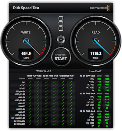

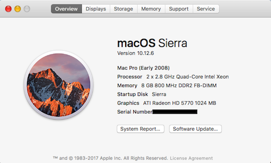

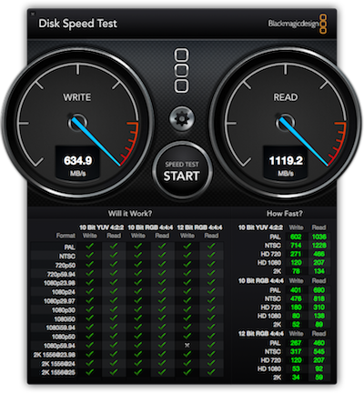

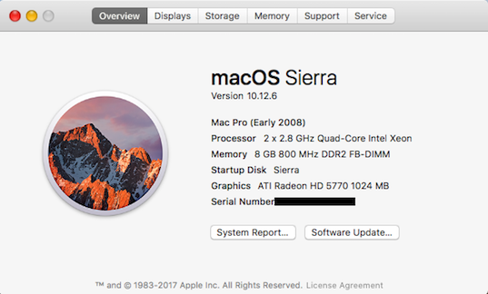

Hello, fellow Mac Pro 2008 owner! I've done the following upgrades to my machine, and am still quite pleased with the results:
I didn't buy all these things at these prices. I looked around for better deals, but that gives you the gist. Good luck!

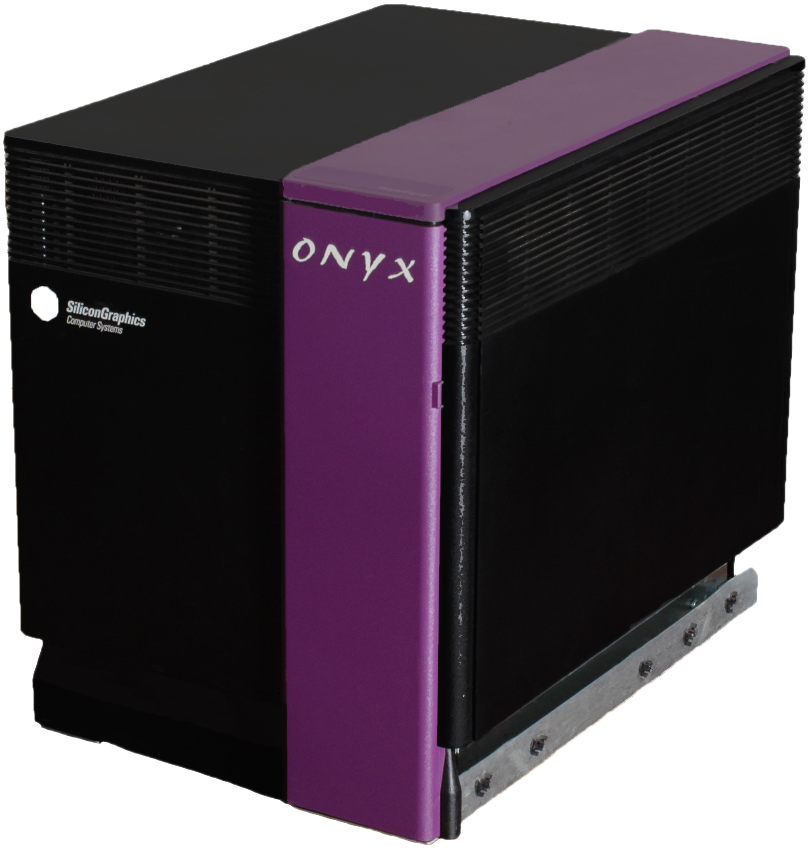

Personally, the massive heat sinks, riser cards, intense heat output, weight, and likeness to the G5 make me really appreciate the '06 and '08 Mac Pros, since they function so much like a workstation from back in the day, which I think is really charming.
Almost brings to mind Silicon Graphics' hulking visualization machines, like the Onyx... But perhaps I am getting ahead of myself.
Then again... Perhaps not.
can you boot off an SSD in the PCI card on the MP2008?
My MacPro 3,1 is a 2.8ghz 8 Core. I upgraded it to 20gb of ram, threw in an SSD in one of the extra sata ports, and put a GTX 1060 in it. The thing honestly flies. Its even good for modern games on all high settings as all modern games support multiple cores. Most i7s aren't even true 8 cores. I haven't gotten this thing to use close to the full 20gb of ram other than running a bunch of VMs. For everyday use the sata II SSD is just fine. I've read that the 3,1 doesn't have a good track record on booting anything from a PCIe slot. If you had a 4,1 it'd be a different story. I have't actually tried to do it as I don't have a PCIe SSD, but after reading so many mixed reports on it I decided to play it safe and stay with sata.
This thing outperforms my Vaio with an i7, despite being about 5 years older than it. granted the Vaio is dated too. Thats still a big gap in the tech world.
Reactions: z970
I boot my MP3,1 from a PCIe slot using a Kingston Predator AHCI SSD, without any problems whatsoever.
