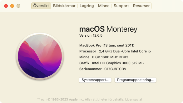

I have one of those with 8 GB RAM (1600 works) and an SSD, with Monterey (via OCLP), and it works fine. I only use it for video conference apps*, but if it were to be my main computer I would have installed 16 GB RAM.
Please see the attached screenshot, (the language is Swedish).
*PS. Apropos video conference apps, I need to share some insights. OCLP isn't enough to get them to work, you also need a small app called Tccplus, which gives much needed permissions to apps that are otherwise impossible to give permissions to within Settings (especially camera and microphone). I have gotten Zoom and WhatsApp to work, but not Messenger. Perhaps Teams and Skype will work, I haven't tried them.

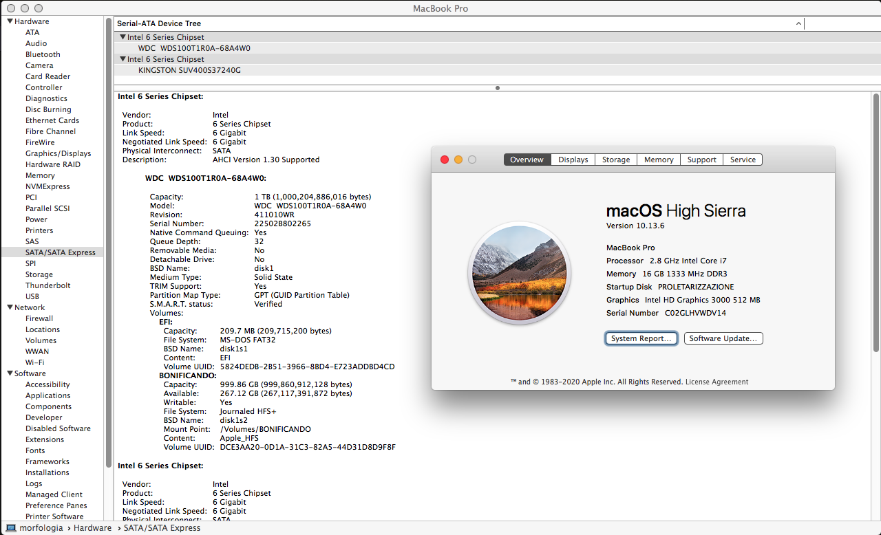

And check the speed of the SATA-connections of your MBP first (Apple-menu/About this Mac/SystemInformation/SATA): the HHD-bay will certainly run at 6Gb/s, but the optical drive might be limited to 3Gb/s, which means, that the transfer-rates of macOS running from the position of the optical drive are cut half. That might make performance of OCLP Monterey even worse. (The mid2012 15" MBP9,1 has 6Gb/s-SATA3 ad both ports, so hopefully Your 2011 MBP too ...)
I can confirm that the late 2011 A1278s yields SATA III/6Gbps speeds on both SATA buses:
In my use-case, the OEM hard drive bay is where 10.6.8 (on a 1TB SSD) lives, and the ODD-caddy is where a 10.13.6 (on a 240GB SSD) lives. On the above, it’s possible to just make out that info for the second SATA bus.
